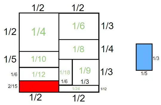

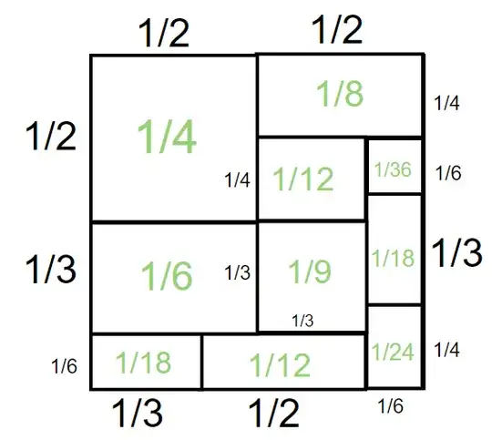

I've been trying to find METs for the EUSS described above: $\{4, 6, 8, 9, 10, 12, 15, 18, 24\}$. Unfortunately, I haven't been successful yet. Here are two failed attempts at tilings. The size of the rectangles is annotated in green.
(1)
We see that it is almost an MET, but not quite. The remaining blue tile of size $\frac{1}{15}$ does not fit in the remaining red space of the unit square. Moreover, the lengths of the sides of the red rectangle are not both unit fractions.
Here, we employed the factorization \begin{align*} 1 &= \ \ \ \ \ \frac{1}{4} \ \ \ \ \ + \ \ \ \ \ \frac{1}{6} \ \ \ \ \ + \ \ \ \ \ \ \frac{1}{8} \ \ \ \ \ + \ \ \ \ \ \ \frac{1}{9} \ \ \ \ \ + \ \ \ \ \frac{1}{10} \ \ \ \ \ + \ \ \ \ \frac{1}{12} \ \ \ \ \ + \ \ \ \ \frac{1}{15} \ \ \ \ \ + \ \ \ \ \frac{1}{18} \ \ \ \ \ + \ \ \ \ \frac{1}{24} \newline &= \left( \frac{1}{2} \times \frac{1}{2} \right) + \left( \frac{1}{2} \times \frac{1}{3} \right) + \left( \frac{1}{2} \times \frac{1}{4} \right) + \left( \frac{1}{3} \times \frac{1}{3} \right) + \left( \frac{1}{2} \times \frac{1}{5} \right) + \left( \frac{1}{2} \times \frac{1}{6} \right) + \left( \frac{1}{3} \times \frac{1}{5} \right) + \left(\frac{1}{3} \times \frac{1}{6} \right) + \left(\frac{1}{2} \times \frac{1}{12} \right). \end{align*}
We call this factorization $(3)$.
We now move to the second non-example:
(2)
(Please ignore the unevenness of the square - this is due to my poor drawing skills.)
In this case, all rectangles do tile the unit square. However, there's trouble in paradise: some of the tiles are used twice. The tiles of size $\frac{1}{12}$ and $\frac{1}{18}$ are both employed twice. Moreover, the tiles of size $\frac{1}{10}$ and $\frac{1}{15}$ are missing. This is not allowed.

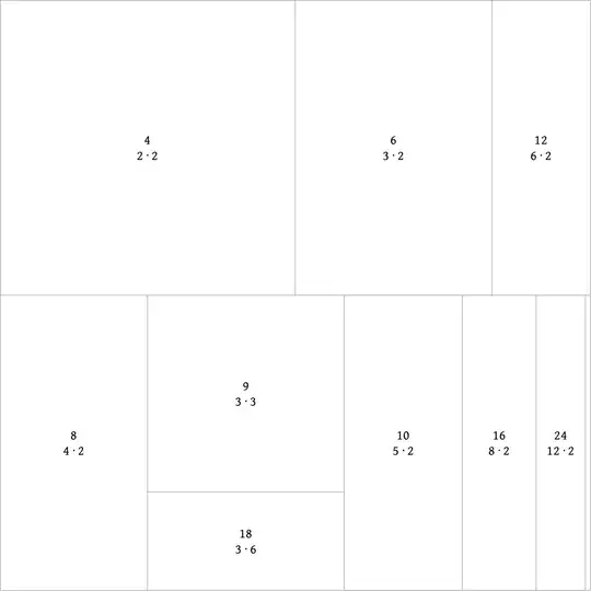

There is no MET for $n=9$, so the answer to all of your questions is negative.
Here’s Java code that generates all composite EUSSs for a given value of $n$ and finds all METs for them. The only composite EUSS for $n=9$ is the one you tried, and no MET for it is found. There are $46$ composite EUSSs for $n=10$, and $11$ of them (marked with an asterisk) admit at least one MET:
4, 6, 8, 9, 10, 12, 14, 15, 39, 6552

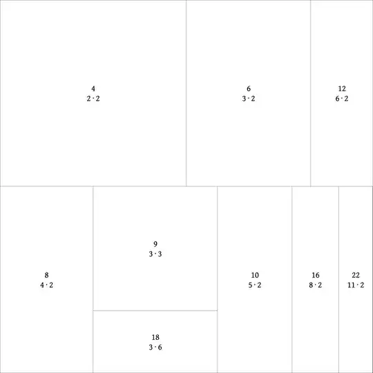

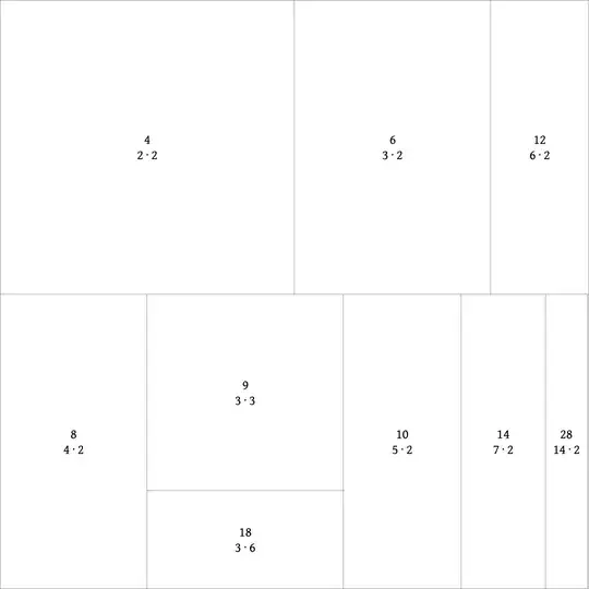

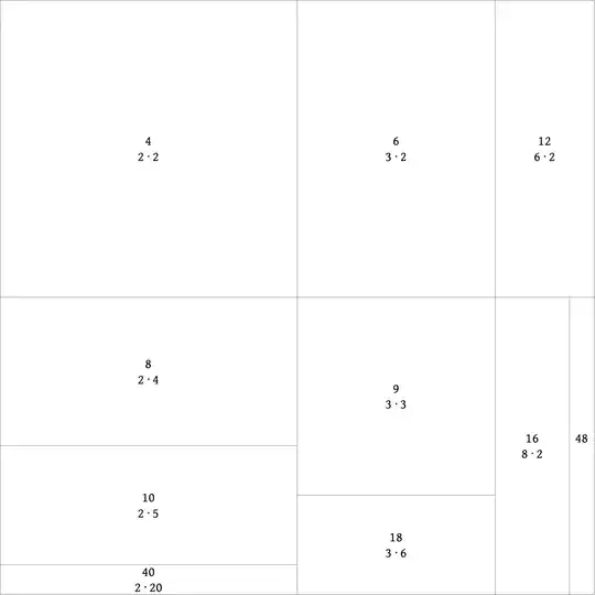

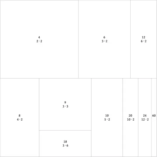

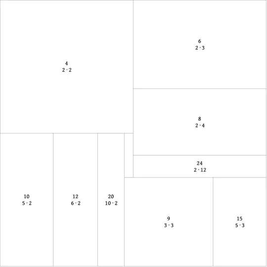

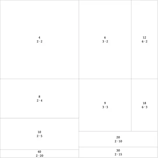

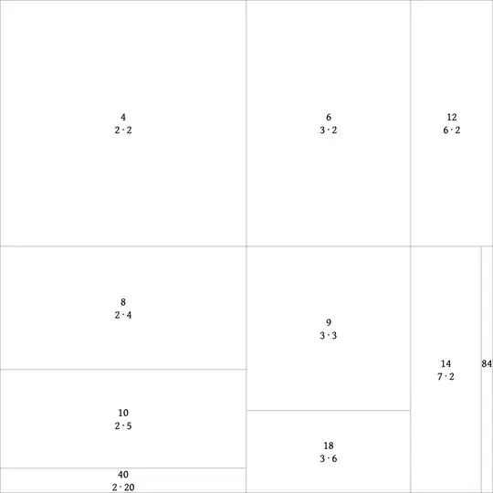

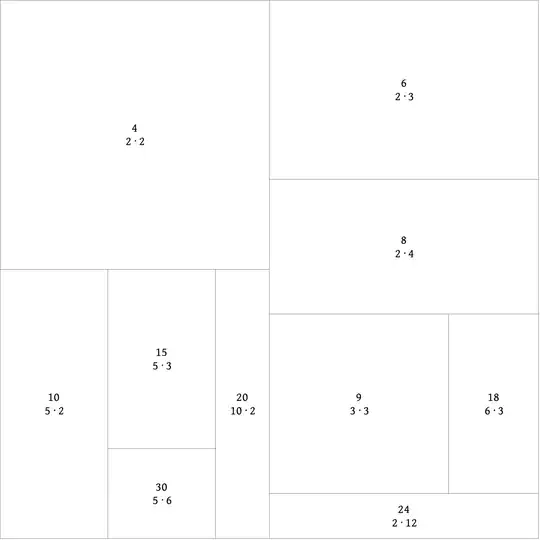

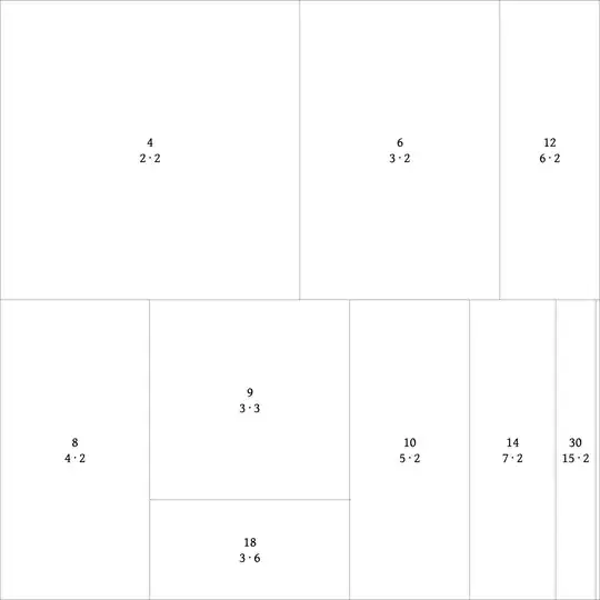

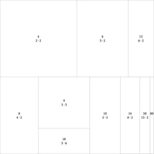

Here are images of METs for the $11$ composite EUSSs with $n=10$ that admit them. Areas less than $\frac1{100}$ aren’t labelled because there’s not enough space; since there’s at most one of those per image, you can deduce it from the EUSS. The factorizations that are missing for lack of space can be deduced from those of the other rectangles. You can click on the images to get them in full resolution; then the rectangle with area $\frac1{2640}$ (in the fifth image) appears at the lower right.
$4, 6, 8, 9, 10, 12, 14, 18, 28, 840$:
MET 1
$4, 6, 8, 9, 10, 12, 14, 18, 30, 280$:
MET 2
$4, 6, 8, 9, 10, 12, 14, 18, 40, 84$:
MET 3
$4, 6, 8, 9, 10, 12, 15, 20, 24, 180$:
MET 4
$4, 6, 8, 9, 10, 12, 16, 18, 22, 2640$:
MET 5
$4, 6, 8, 9, 10, 12, 16, 18, 24, 240$:
MET 6

$4, 6, 8, 9, 10, 12, 16, 18, 40, 48$:
MET 8
$4, 6, 8, 9, 10, 12, 18, 20, 24, 60$:
MET 9

joriki
  • 242,601
  • Interesting, thank you! Do you have any ideas as to why some composite EUSSs admit at least one MET, while others don't? Do they share some particular characteristic(s)? – Max Lonysa Muller Mar 07 '24 at 20:28
  • @MaxMuller: I don’t, unfortunately. The one in the image has quite low integers with no prime factor greater than $5$, but some of the EUSSs that admit an MET have quite high integers, in one case with a prime factor $11$. I don’t see any pattern. If you like I can post images of some (or all) of the other METs. – joriki Mar 07 '24 at 20:55
  • Yes, I'm definitely interested - especially in the METs of EUSSs with high integers, like the one with the number 2640 as the denominator of the last unit fraction. – Max Lonysa Muller Mar 07 '24 at 20:58
  • @MaxMuller: OK, I added an MET image for all composite EUSSs with $n=10$ that admit one. It’s interesting that the one for $4,6,8,9,10,12,15,20,24,180$ is the only one that doesn’t fill two halves of the square separately. – joriki Mar 08 '24 at 01:10
