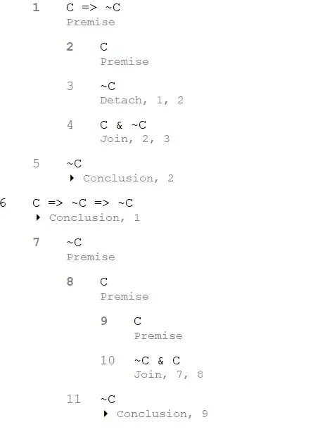

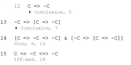

$C\implies \neg C~~$ is "problematic" only if $C$ is true.
It is trivial to prove: $~~(C \implies \neg C)\iff \neg C$
The truth table:
Using a form of natural deduction (not using the truth table):
Plain text version:
1   C => ~C
    Premise
2   C
    Premise
3   ~C
    Detach, 1, 2
4   C & ~C
    Join, 2, 3
5 ~C Conclusion, 2
6 C => ~C => ~C Conclusion, 1
7 ~C Premise
8   C
    Premise
    9   C
        Premise
    10  ~C & C
        Join, 7, 8
11  ~C
    Conclusion, 9
12 C => ~C Conclusion, 8
13 ~C => [C => ~C] Conclusion, 7
14 [C => ~C => ~C] & [~C => [C => ~C]] Join, 6, 13
15 C => ~C <=> ~C Iff-And, 14
