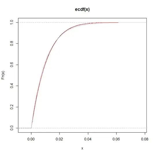

Here is a simulation in R to confirm this expectation, using $n=10$.
mingap <- function(n){
  x <- runif(n-1)
  gap <- diff(c(0,sort(x),1))
  return(min(gap))
set.seed(2024) n <- 10 sims <- replicate(10^5, mingap(n)) mean(sims) # expected 1/n^2
0.01000694
The black curve below is the empirical CDF from the simulation, with the red theoretical CDF $1 - (1-ny)^{n-1}$ almost exactly matching it and so obscuring it. The grey exponential CDF for $Exp(n^2)$ gives a fairly close approximation.
plot.ecdf(sims)
curve(1-(1-n*x)^(n-1),from=0, to=1/n, add=TRUE, col="red" )
curve(1-exp(-x*n^2),from=0, to=1/n, add=TRUE, col="grey" )
CDFs
