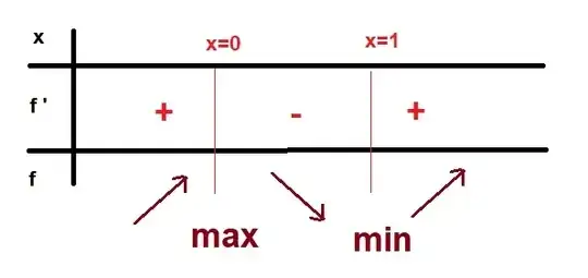

or take $f(x)=2mx^{2m+1}-(2m+1)x^{2m}+1$ $$f'(x)=2m(2m+1)x^{2m}-(2m+1)2mx^{2m-1}=\\2m(2m+1)x^{2m-1}(x-1)=0\\ \to f'=0 \to x=0,1 \\ f(x)=(x-1)^2(somthing)$$ you can draw $f'(x)$ table of sign enter image description here
and finally with respect to $f'$ sign ,you have $$x=1,1 \ or \ (x-1)^2$$and other negative root
