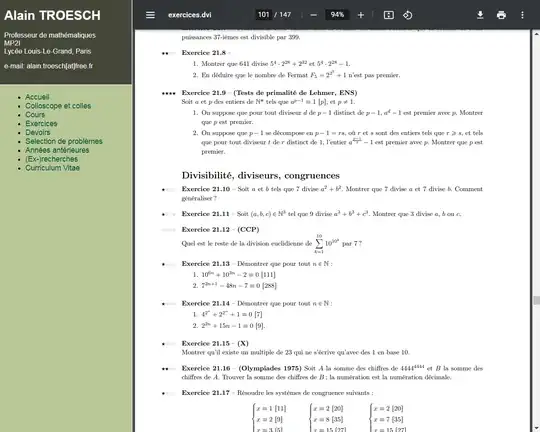

Source : Alain Troesch (Louis-le-Grand High School, Paris) , Exercices $2022-2023$, Polycopié des exercices , page $99$, Ex. $21.10$ http://alain.troesch.free.fr/
Given ( by hypothesis) that $7 | a^2 + b^2$ with $a, b \in \mathbb Z$. Prove that $ 7$ divides both $a$ and $b$.
