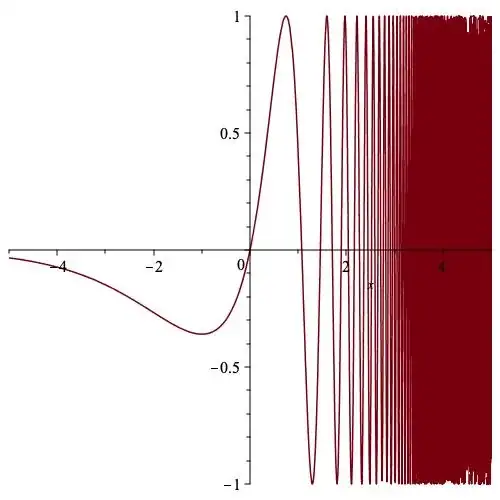

Here is the graph of $\sin(xe^x)$
graph
Of course the integral $\int_{-\infty}^0$ converves. But how do we know that $\int_0^\infty$ converges?
