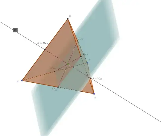

OP concludes (with no direct argument) that one of the two points $S,S'$ is on an edge, and not a vertex. Say $S$ is this point, and it is on the edge $AB$. Let $A',B'$ be the other two vertices. The rotation axis $SS'$ must pass through the center $C$, and $SC$ intersects the edge $A'B'$ in its mid point, so $S'$ is this mid point of $A'B'$. Now i would argue as follows. Let $M_{XY}$ be the mid point of an edge $XY$. So $S=M_{AB}$, $S'=M_{A'B'}$.
mse 4862489
So we must have a rotation around $(l)=SS'$ that preserves the four mid points in the plane through $C$ perpendicular on $(l)$. Only $90^\circ$-multiples are thus allowed. But a $\pm 90^\circ$-rotation moves $A$ not in a vertex, so we have to take the $180^\circ$-rotation, which brings $A\leftrightarrow B$, and $A'\leftrightarrow B'$. With this argument (replacing the paragraph between the stars) there is nothing to object. We can also look how faces may move, but this is an argument depending on the visualization, to have it rigorous, one has to consider vertices or edges...
