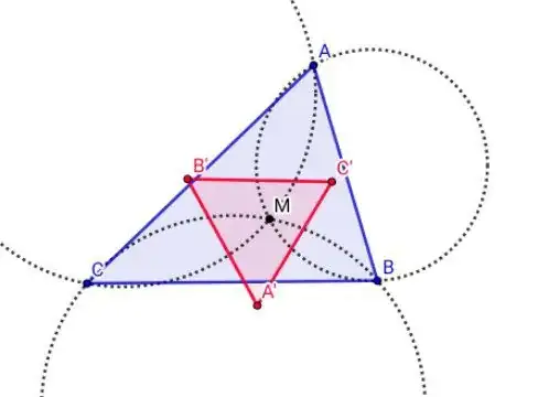

Suppose a triangle $∆ABC$, what is required is to determine the appropriate position of the point M that makes the triangle $∆A'B'C'$ To be an equilateral triangle where the points $A',B',C'$ are the inversion of the vertices of the triangle with respect to the three circles that each pass through two vertices of the triangle. And the point $M$

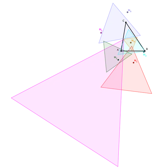

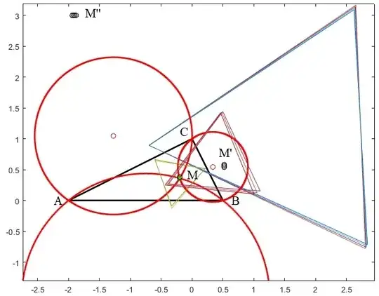

let us have a closer look. On fig. 1, a first point $M$ has been privilegized for the reproduction of the figure as given in the question. $M$, like other positions $M', M''$ are candidates obtained by a systematic "browsing", using a $400 \times 400$ grid of points of the area covering the triangle and its vicinity. It is why the displayed point(s) are close to the points realizing an equilateral triangle but not exactly coinciding with them ; as a consequence, we have a little "fuzzyness" for displayed triangles.
Fig. 1 : Triangle $A(-2,0), B(0.5,0), C(0,1)$ ; circles $(ABM),(MBC),(AMC)$ with common point $M$ in green giving light grey triangle (all this is similar to your figure). But there are two other points $M'$ and $M''$ associated resp. with purple and blue "equilateral" triangles.

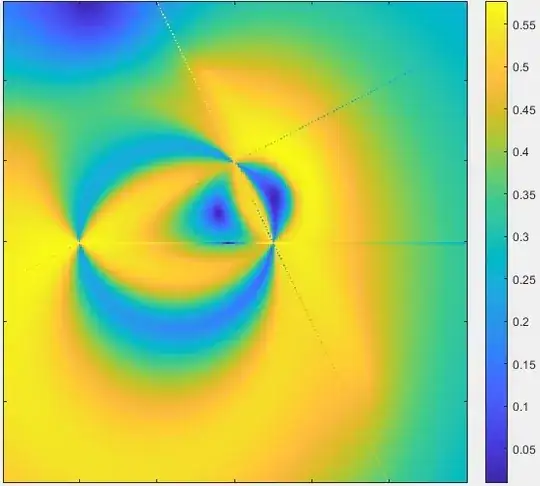

Fig. 2 : (in connection with Fig. 1) ; Color display of a function characterizing "equilateralness" on a scale with minimal value $0$ (deep blue) for perfect equilateralness. One recognizes in this diagram the shape of (prolongated) triangle $ABC$ and the places where points $M,M',M''$ are situated.

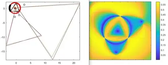

Fig. 3 : Another example with an acute triangle $A=(-2,-1), B=(1,-1), C=(0,2)$ which can be seen on the upper left corner of the left figure where we can see (at least) three triangles. On the right figure one can notice three deep blue regions corresponding to these three triangles plus a whole circle which looks as a continuous locus of points $M$. Honestly, I haven't well understood all in this pretty figure.

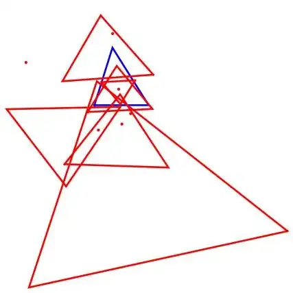

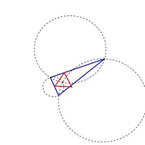

Follows a MATHEMATICA script which calculates an equilateral triangle obtained by inversion, (red) preferably when the common point to invert, (red) is located inside the original triangle (blue). There are problems of poor numerical conditioning in case of squashed triangles. Changing the value of SeedRandom[15] we can generate other base triangles.
Clear[circ]
circ[p_, p0_, r_] := (p - p0) . (p - p0) - r^2
Clear[solvecirc] solvecirc[p1_, p2_, g_] := Module[{p0, x0, y0, equ1, equ2, equ3, sols, r0, ind, r}, p0 = {x0, y0}; equ1 = circ[p1, p0, r]; equ2 = circ[p2, p0, r]; equ3 = circ[g, p0, r]; sols = Quiet@NSolve[{equ1 == 0, equ2 == 0, equ3 == 0}, {x0, y0, r}][[2]]; Return[{p0, Abs[r]} /. sols]; ]
Clear[extcirc] extcirc[tri_, g_] := Module[{p1 = tri[[1]], p2 = tri[[2]], p3 = tri[[3]], sol1, sol2, sol3}, sol3 = solvecirc[p1, p2, g]; sol1 = solvecirc[p2, p3, g]; sol2 = solvecirc[p3, p1, g]; Return[{sol1, sol2, sol3}] ]
Clear[invert] invert[g_, p0_, r_] := Module[{d}, d = Norm[g - p0]; Return[p0 + (g - p0) (r/d)^2] ]
Clear[equilat] equilat[tri_, g_] := Module[{circs, invs, l1, l2, l3}, circs = extcirc[tri, g]; invs = Table[invert[tri[[k]], circs[[k, 1]], circs[[k, 2]]], {k, 1, 3}]; l1 = (invs[[1]] - invs[[2]]).(invs[[1]] - invs[[2]]); l2 = (invs[[2]] - invs[[3]]).(invs[[2]] - invs[[3]]); l3 = (invs[[1]] - invs[[3]]).(invs[[1]] - invs[[3]]); Return[(l1 - l2)^2 + (l2 - l3)^2 + (l1 - l3)^2] ]
SeedRandom[15]; toler = 0.0001; tri = RandomReal[{-1, 1}, {3, 2}]; regs = BoundaryDiscretizeGraphics[ListLinePlot[Join[tri, {tri[[1]]}]]]; sol = Quiet@NMinimize[{equilat[tri, {x, y}], {x, y} [Element] regs}, {x, y}, Method -> "DifferentialEvolution"] If[sol[[1]] > toler, sol = Quiet@NMinimize[equilat[tri, {x, y}], {x, y}, Method -> "DifferentialEvolution"] ]
GRF = {}; If[sol[[1]] < toler, g = {x, y} /. sol[[2]]; circs = extcirc[tri, g]; invs = Table[invert[tri[[k]], circs[[k, 1]], circs[[k, 2]]], {k, 1, 3}]; gr1 = ListLinePlot[Join[tri, {tri[[1]]}], PlotStyle -> Blue]; AppendTo[GRF, gr1]; gr2 = Graphics[{Red, PointSize[0.01], Point[g]}]; AppendTo[GRF, gr2]; gr4 = ListLinePlot[Join[invs, {invs[[1]]}], PlotStyle -> Red]; AppendTo[GRF, gr4]; gr5 = Table[Graphics[{Dashed, Circle[circs[[k, 1]], circs[[k, 2]]]}], {k, 1, 3}]; AppendTo[GRF, gr5]; Show[GRF, PlotRange -> {{-2, 2}, {-2, 2}}, AspectRatio -> 1], Print["Out of tolerance"] ]

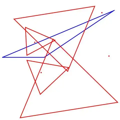

Analyzing the excellent answer from @intelligenti pauca, and using the same formalism used in my previous answer, we developed a formal (algebraic) formulation which works quite well. For simplicity, the initial triangle has coordinates
$$ (0,0),(0,3),(n_x,n_y) $$
where $n_x, n_y$ are random integers in the range $(0,10)$. According to the results, we can obtain four or six solutions. Follows the script which reuses the methods already defined previously
solvecirc[p1_, p2_, g_] := Module[{p0, x0, y0, sols, r0, r}, p0 = {x0, y0}; sols = Solve[{circ[p1, p0, r] == 0, circ[p2, p0, r] == 0, circ[g, p0, r] == 0}, {x0, y0, r}][[2]]; Return[{p0, r^2} /. sols // Simplify] ]
invert[g_, p0_, r2_] := p0 + (g - p0) r2/(g - p0) . (g - p0)
g = {gx, gy}; {p12, r12} = solvecirc[{x1, y1}, {x2, y2}, g] // Simplify; {p23, r23} = solvecirc[{x2, y2}, {x3, y3}, g] // Simplify; {p31, r31} = solvecirc[{x3, y3}, {x1, y1}, g] // Simplify; p1 = invert[{x1, y1}, p23, r23]; p2 = invert[{x2, y2}, p31, r31]; p3 = invert[{x3, y3}, p12, r12]; equ1 = (p1 - p2) . (p1 - p2) - (p2 - p3) . (p2 - p3); equ2 = (p2 - p3) . (p2 - p3) - (p3 - p1) . (p3 - p1); equ3 = (p3 - p1) . (p3 - p1) - (p1 - p2) . (p1 - p2); SeedRandom[1]; parms = {x1 -> 0, y1 -> 0, x2 -> 3, y2 -> 0, x3 -> RandomInteger[{0, 10}], y3 -> RandomInteger[{0, 10 ]}
equs = {equ1, equ3} /. parms; solsg = Solve[equs == 0, g, Reals] // N circs = {{p12, r12}, {p23, r23}, {p31, r31}} /. parms /. solsg // N; points = {p1, p2, p3} /. parms /. solsg; gs = {gx, gy} /. solsg; gr1 = ListLinePlot[{{x1, y1}, {x2, y2}, {x3, y3}, {x1, y1}} /. parms, PlotStyle -> Blue]; gr2 = Table[ListLinePlot[Join[points[[k]], {points[[k, 1]]}], PlotStyle -> Red], {k, 1, Length[points]}]; gr3 = Graphics[{Red, PointSize[0.01], Point[gs]}]; Show[gr1, gr2, gr3, PlotRange -> All, AspectRatio -> 1, Axes -> False]
Follows a case with SeedRandom[1] which gives six solutions
and other with SeedRandom[2] which gives four solutions
