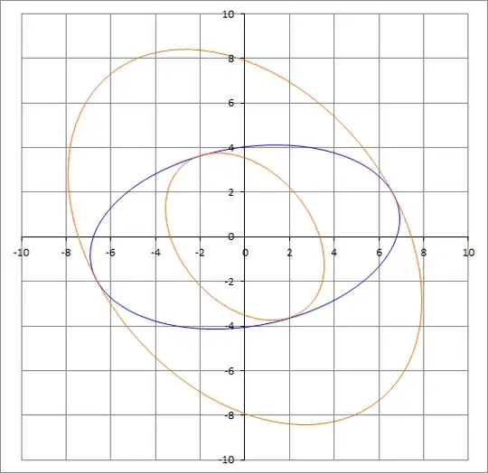

I've written a small program to plot the two ellipses for each value of $l$. The plots show that the formula for $l$ is correct.
The code is shown below.

The output of this code is the original ellipse (blue) and the two tangential ellipses (orange).

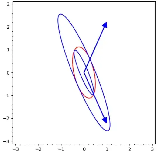

We can assume WLOG (up to division by a constant) that the first ellipse $(E)$ has equation
$$X^TAX=1$$
Let $X^TBX=\ell$ be the second variable ellipse that we will call $(E_{\ell})$.
Result : the values of $\ell$ warranting an internal, resp external, tangency of $(E_{\ell})$ with $(E)$ are the smallest, resp. largest, of the eigenvalues of matrix :
$$C:=A^{-1}B$$
Moreover, the points of contact of the curves are given by eigenvectors of this matrix $C$.
Proof :
Curve $(E_{\ell})$ touches curve $(E)$ in a point $X=\pmatrix{x\\y}$ if the two curves have proportional gradients (normal vectors) in this point :
$$2BX = \lambda 2AX\tag{1}$$
for a certain $\lambda$. Pre-multiplying (1) by $A^{-1}$ :
$$\underbrace{(A^{-1}B)}_CX=\lambda X\tag{2}$$
in which we recognize an eigenvector and an eigenvalue of $C$.
Now, with if we multiply LHS and RHS of (1) by $X^T$, we get :
$$X^TBX = \lambda \underbrace{X^TAX}_{=1}\tag{3}$$
That's all...
Fig. 1 : Ellipse $(E)$ is figured in red. The two ellipses $(E_{\ell})$ internaly and externaly tangent to $(E)$ are in blue.
The Sage program that has produced the figure above is given below ; you can easily execute it by calling https://sagecell.sagemath.org/, copy-paste the program into the edit window, then press button "Evaluate".
Please note
  • that $X^TAX$ is represented as the dot product of $X$ by $AX$.
  • that the (unnormalized) eigenvectors indicate the direction of tangency points. One can normalize them in order that their extremities are precisely on these points.
