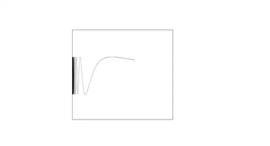

It is false. Let $B$ be the following compact subset of $\mathbb R^2$:
It is the union of the boundary of a square $R$ and a copy of the topologist's sine curve
$$S = \{(x,\sin(1/x) \mid x \in (0,1]\} .$$
This set is connected, but not path-connected. To see this one can adapt the standard proof for the closed topologist's sine curve $S' = S \cup (\{0\} \times [-1,1])$ in math.stackexchange.
The region $E = R \setminus B$ is open in $\mathbb R^2$ and one can show that it is simply connected. But the boundary of $E$ is $B$ which is not path-connected.
