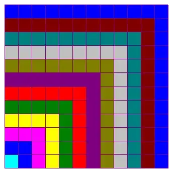

Apart from the standard proof by induction for the sum of the first odd numbers $1+3+\cdots +(2n-1)$, I'm pretty sure that you are all aware of the beautiful "picture proof" :
