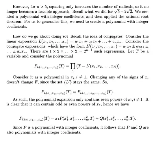

Here are my notes from 10 years ago, which might have errors in them. I did not come up with this argument.
I know images aren't ideal, but I'm too lazy to type this up. Feel free to delete/edit/vote this solution as desired.

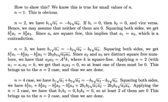

(You can ignore the following note about how to use repeated squaring for $n \leq 4$. However, this doesn't extend to more variables.)

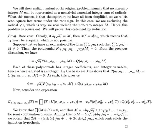

We're now ready to proof a slight variant of the theorem listed at the start, and is a slightly stronger statement than what OP asked for (as it allows for negative coefficients):
If $ \{ a_i \}$ are distinct numbers from the set $SF \backslash \{1 \}$, and $\{ b_i\}$ are any integers, then $ S = \sum b_i \sqrt{a_i } \in \mathbb{N}$ if and only if all $ b_i = 0 $ (and hence $ S = 0 $ ).
Motivation: The field theoretic idea here is that if $ S = \sum b_i \sqrt{a_i}$, then for any prime $ p \mid a_1$ replacing $\sqrt{p}$ with $ - \sqrt{p}$ throughout will still retain the validity of the expression. This implies that $ S = -b_1 \sqrt{a_i} + \sum \pm b_i \sqrt{ a_i } $ for a known set of $ \pm b_i$ where the signage depends only on whether $p \mid a_i $. Adding these two expressions, we get $ 2 S $ as the sum of fewer radical terms, so an induction approach could work.
We will merely show the weaker result that $ S = -b_1 \sqrt{a_1} + \sum_{i=2}^n \pm b_i\sqrt{a_i} $ for some suitable choice of signs, which is sufficient to add these expressions and reduce the number of terms.
The backwards part is obvious. We prove the forward part by induction.
Base case: If $ b_1 \sqrt{a_1} = S$ with $b_1 \neq 0$ then $b_1^2 a_1 = S^2$ and so $a_1 $ is a perfect square, which is not possible in $ SF \backslash \{ 1 \}$. Thus $b_1 = 0 $.
Induction step: Suppose it is true for $n-1$ summations.
Case 1: $ S = 0 $.
Multiply throughout by $\sqrt{a_i}$. Since $a_i \neq a_1$, so $ a_i a_1 = k_i^2 a_i'$ where $a_i' \in SF \backslash \{ 1 \}$.
Thus $\sum_{i=2}^n (b_i k_i) \sqrt{a_i'} = - b_1 a_1 \in \mathbb{N}$.
Applying the induction hypothesis, we get $ b_i' = 0 \Rightarrow b_i = 0 $ for $i = 2$ to $n$, and $ 0 = S = b_1 \sqrt{a_1} \Rightarrow b_1 = 0 $.
Case 2: $ S \neq 0 $.
Set up $F_{L(\sqrt{a_1}, \sqrt{a_2}, \ldots \sqrt{a_n} )} (T) $ from the previous discussion, so $F_{L(\sqrt{a_1}, \sqrt{a_2}, \ldots \sqrt{a_n} )} (S) = 0 $, and
$$ 0 = \sqrt{a_1} P(a_1, a_2, \ldots a_n, S) + Q(a_1, a_2, \ldots , a_n, S).$$
The polynomials $P$ and $Q$ have integer coefficients, so when evaluated at the integers will give us integer values, thus $ 0 = \sqrt{a_1} P^* + Q^*$ and hence these values are also 0. Thus, $ 0 = -\sqrt{a_1} P^* + S^*$.
Now, consider $$ \begin{array} { r l } G_L(T) & = \prod [ T + L'(x_1, x_2, \ldots, x_n) ] \\ & = \prod [ T - L'(-x_1, x_2, \ldots, x_n) ] \\ & = -x_1 P(x_1^2, x_2^2, \ldots , x_n^2, T) + Q(x_1^2, x_2^2, \ldots , x_n^2, T). \end{array} $$
Since $ 0 = - \sqrt{a_1} P^* + Q^* = \prod(S + L')$, so there exists some $S+L^* = 0$.
We have $S = -b_1 \sqrt{a_1} + \sum_{i=2}^{n} c_i \sqrt{a_i}$ where $ c_i \in \{ b_i, -b_i \}$.
Adding up the 2 expressions for $S$, we get that $2S = \sum_{i=2}^n (b_i + c_i) \sqrt{a_i}$ and hence by the induction hypothesis $2S = 0$.
This is a contradiction, so this case cannot occur.
