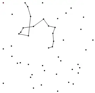

One year ago, my uncle set off from our village on an epic journey, in which every day he travels to the nearest unvisited village and stays there for the night. The villages in our country are randomly located (independently and uniformly) with an average of $1$ village per square mile. Our village is in the middle of a very large country, such that my uncle could not possibly reach the border within one year.
Here is an example of what the first two weeks of his journey could look like.
I haven't heard from my uncle since he left, and I don't have a map. How far away do you reckon he is now? That is,
What is the expectation of his distance (as the crow flies) from our village?
