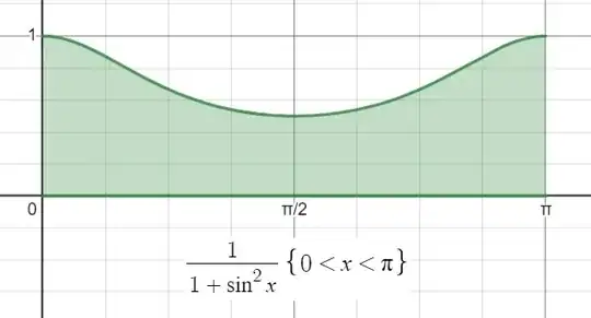

As a hint : divide into two equal integral $$\int_0^{\pi} \frac{x}{1+sin^2{x}}=\int_0^{\frac{\pi}{2}} \frac{x}{1+sin^2{x}}dx +\int_{\frac{\pi}{2}}^{\pi} \frac{x}{1+sin^2{x}}dx\\=2\int_0^{\frac{\pi}{2}} \frac{x}{1+sin^2{x}}dx $$ zero is cause of symmetry in the interval enter image description here

  • @Crustocean01: I added a picture that shows why $\int=F(\pi)-F(0)=0-0$ you did not anything wrong ,but the function symmetry on the interval causes zero , if you take twice on $[0,\pi/2]$ then your substitution works – Khosrotash Feb 02 '24 at 12:08
  • Could you please elaborate what symmetry has to do with the integral becoming zero, also shouldn't the function have x in the numerator? – Crustocean 01 Feb 02 '24 at 12:18
    @Crustocean01: it is a periodic function with $T=\pi$ so the integral of the function is periodic too, so the $F(\pi)-F(0)=0$ it doesn't about symmetry at all, but symmetry helps you to find it's value. – Khosrotash Feb 02 '24 at 12:27
  • So it becomes mandatory to change limit from [0,pi] to [0,pi/2] in such integrals involving periodicity? I thought these properties of definite integrals were typically used to make complex problems simpler, but here it appears to be the only way to get the required solution. – Crustocean 01 Feb 02 '24 at 12:37
  • The integrals over $[0,\pi/2]$ and $[\pi/2,\pi]$ of the function ${x\over 1+\sin^2x}$ are not equal. The first one is less than the second one. – Ryszard Szwarc Feb 02 '24 at 21:58
