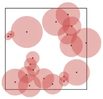

A unit square lamina contains $n$ independent uniformly random points. Each point is the centre of a disc whose perimeter touches the nearest neighboring point. Here is an example with $n=20$.
In this example, the total area of the discs (i.e. the sum of areas of the discs, not the area of the union of the discs) is approximately $1.0105$.
What does the total area of the discs approach, as $n\to\infty$ ?
The answer is $1$, i.e. the area of the square itself. I give a non-intuitive proof below. But since this result is quite elegant, I am looking for an intuitive explanation.

Imagine adding an $(n+1)$-th point. For each of the $n$ existing points, the probability that the new point becomes the existing point’s nearest neighbour is $\frac1n$. Thus by linearity of expectation the expected number of points whose nearest neighbour the new point becomes is $1$. The disks mark the area where a new point would become the disc centre’s nearest neighbour. Thus, the sum of the disc areas inside the square is the integral over all points $x$ (and thus the expectation) of the number of points whose nearest neighbour $x$ would become if it were added as a new point. By the above, the expected value of this sum averaged over all configurations of the $n$ points is $1$. Since parts of the areas lie outside the square, their total area is expected to be slightly larger than $1$, but with $n\to\infty$ the proportion of the disc areas that lie outside the square goes to zero.
