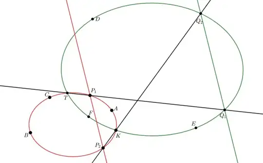

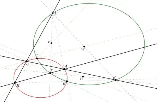

Let $\triangle ABC$ be a triangle and $K$ some other generic point (*). Let $\triangle DEF$ be the cevian triangle of $\triangle ABC$ with respect to $K$. That is, $D$ is where $AK$ meets $BC$, $E$ is where $BK$ meets $CA$, and $F$ is where $CK$ meets $AB$.
If $U,V,W$ are the respective midpoints of $EF, FD, DE$ then it can be proved (using areal coordinates for example) that the three lines $AU,BV,CW$ are concurrent, at $T$ say. Let $\mathcal{C}_1$ be the conic through $A,B,C,K$ and $T$, and $\mathcal{C}_2$ be the conic through $D,E,F,K$ and $T$.
It appears that $\mathcal{C}_1$ and $\mathcal{C}_2$ are directly similar i.e. have the same eccentricity and the same "orientation". My questions are whether or not this is known and how to prove explain it?
(Update 27/01/24: They in fact do not always have the same eccentricity when they are hyperbolas. See below for details which contains a sketch proof that was found with the help of a computer. I'm still not able to explain the relationship between the two conics so I am updating the question rather than posting an answer.)
I was initially interested in drawing these conics because it would follow that, if $P_1$, $P_2$ are two points on $\mathcal{C}_1$ and $Q_1, Q_2$ are two points on $\mathcal{C}_2$ such that $P_1KQ_1$ are collinear and $P_2TQ_2$ are collinear then $P_1P_2$ and $Q_1Q_2$ are parallel.
I can write down the equations of the conics in areal coordinates (with respect to $\triangle ABC$) in terms of the coordinates of $K$, and this allows me to calculate their centres and show using a fairly complicated identity that $\mathcal{C}_1$ is an ellipse/hyperbola if and only if $\mathcal{C}_2$ is an ellipse/hyperbola (making use of formulae from Chapter 2 of The Algebra of Geometry by C. J. Bradley) but I'm not sure if this is the best approach because the algebra seems to be getting too complicated to do much more.
(*) Specifically, $K$ is not on $AB,BC$ or $CA$, nor on the medians of $\triangle ABC$, nor on the line through $A$ parallel $BC$, the line though $B$ parallel to $CA$ or the line through $C$ parallel to $AB$.

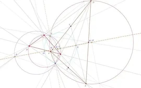

Lemma A: Let $\Delta ABC$ be a triangle with circumcenter $O=X(3)_{ABC}$ and circumcircle $(O)=(ABC)$. Consider $K$ a further point on the circumcircle. Let $\Delta DEF$ be the cevian triangle associated with $K$, $D\in BC$, $E\in CA$, $F\in AB$. Let $\Xi=X(2)_{DEF}$ be the centroid of $\Delta DEF$, and $\Delta UVW$ be its cevian triangle in $\Delta DEF$, so $U,V,W$ are the mid points of $EF,FD,DE$. Let $\Psi$ be the mid point of the segment $FT$.
Then: $(i)$ $AU$, $BV$, $CW$ are concurrent in a point $T$.
Assume from now on that $T$ is also a point on the circumcircle $(O)=(ABC)$.
Then: $(ii)$ The points $DEFTK$ are also on a circle $(O')$ with center $O'$.
$(iii)$ The points $OT\Xi K$ are on a circle, centered in a point denoted by $\Upsilon$, the mid point of the diameter $O\Xi$.
$(iv)$ The circumcenter $O$ of $(ABCKT)$, the mid point $\Psi$ of $FK$, the centroid $\Xi$ of $\Delta DEF$, the circumcenter $O'$ of $(DEFTK)$, and the circumcenter $\Upsilon$ of $OT\Xi K$ are colinear. Let $\color{orange}{(L)}$ be this line.
$(v)$ $L$ is perpendicular on $FK$ (in $\Psi$).
mathematics stackexchange question 4848315 projective geometry ellipses in a triangle
Proof:
We use barycentric coordinates $(x,y,z)$ w.r.t. $\Delta ABC$, with sides of lenghts $a,b,c$. The notation $(x,y,z)$ implicitly assumes the norming condition $x+y+z=1$. If we relax it to $x+y+z\ne 0$, then we write $[x:y:z]$.
Then the involved points, line and circles have the following equations: $$ \begin{aligned} A &=(1,0,0)\ ,\\ B &=(0,1,0)\ ,\\ C &=(0,0,1)\ ,\\[2mm] (O)\qquad 0 &=a^2yz + b^2 zx+c^2xy\ ,\\[2mm] &\qquad\text{ Convention / abuse of notation: }A=a^2\ ,\ B =b^2\ ,\ C = c^2\ .\\ &\qquad\text{ The the above equation can be rewritten:}\\[2mm] (O)\qquad 0 &=Ayz + Bzx + Cxy\ ,\\[2mm] O&=[A(B+C-A)\ :\ B(C+A-B)\ :\ C(A+B-C)]\ ,\\[2mm] K &= [l:m:n]\ ,\\ D &= [0:m:n]\ ,\\ E &= [l:0:n]\ ,\\ F &= [l:m:0]\ ,\\[2mm] U &=\frac 12(E+F)\\ &=\frac 12\left(\left(\frac l{l+n},0,\frac n{l+n}\right) + \left(\frac l{l+m},\frac m{l+m},0\right)\right)\\ &=\frac 12\left(\frac l{l+n} + \frac l{l+m},\frac m{l+m},\frac n{l+n}\right) \\ &=[*:m(l+n):n(l+m)]\ ,\\ V &=[l(m+n):*:n(l+m)]\ ,\\ W &=[l(m+n):m(l+n):*]\ ,\\[2mm] T &=[l(m+n):m(l+n):n(l+m)]\qquad\text{ is on $AU$ because the $(AUT)$ determinant is}\\[2mm] &\qquad \begin{vmatrix} 1&0&0\\ *&m(l+n)&n(l+m)\\ *&m(l+n)&n(l+m) \end{vmatrix}=0\ . \qquad\text{ So $T=AU\cap BV\cap CW$, showing $(i)$ .} \\[2mm] (O')\qquad 0 &= -a^2yz-b^2zx-c^2xy+(x+y+z)(ux+vy+wz)\ ,\qquad\text{ where }\\[2mm] &\qquad 2u = -a^2\frac{mn}{l(m+n)} + b^2 \frac n{l+n}+ c^2 \frac m{l+m}\ ,\\ &\qquad 2v = +a^2\frac n{m+n} - b^2 \frac {ln}{m(l+n)}+ c^2 \frac l{l+m}\ ,\\ &\qquad 2w = +a^2\frac m{m+n} + b^2 \frac l{l+n}- c^2 \frac {lm}{n(l+m)}\ ,\\[2mm] \Xi &=\frac 13(D+E+F)\\ &=[l(2l+m+n)(m+n)\ :\ m(2m+l+n)(l+n)\ :\ n(2n+l+m)(l+m)]\\ &=[l(e_1+l)(e_1-l)\ :\ m(e_1+m)(e_1-m)\ :\ n(e_1+n)(e_1-n)]\ ,\\ T &=[l(m+n)\ :\ m(l+n)\ :\ n(l+m)]\\ &=[l(e_1-l)\ :\ m(e_1-m)\ :\ n(e_1-n)] \ . \end{aligned} $$ Above, we have introduced $e_1$, the sum of the variables $l,m,n$, $e_1=e_1(l,m,n)=l+m+n$, and at this point let us define also $e_2=e_2(l,m,n)=lm+mn+ln$, $e_3=e_3(l,m,n)=lmn$, so we have from now on notations for the elementary symmetric polynomials in $l,m,n$.
So far, there is no assumption on $K,T$. Let us now assume that these points are on $(O)$. So we have zero in $Ayz+Bzx+Cxy=a^2yz + b^2 zx+c^2xy$ when we plug in the coordinates of $K,T$. So: $$ \begin{aligned} 0&=\sum A\; mn\ ,\qquad\text{ from $K\in(O)$, and for $T$ now:}\\ 0&= \sum A\; mn(l+m)(l+n)= \sum A\; mn(l^2+(lm+ln+mn))= \sum A\; mn\;l^2 \\ &=lmn\sum A\; l\ . \end{aligned} $$ We obtain thus the following zero cyclic sums. (We cycle in the same time $a,b,c$ and $l,m,n$.) It is useful to use $l',m',n'$ for $1/l$, $1/m$, $1/n$ to avoid fractions. $$ \tag{$*$} \bbox[yellow]{ \qquad 0=\sum A\;l=\sum A\;mn=\sum \frac Al=\sum Al'\ . \qquad } $$
It may be useful to note that there are two solutions $[l:m:n]$ for the above equations. Up to a constant we have $$ l = A^2B + A^2C + B^2C + BC^2 - B^3 - C^3 - 2ABC \\ \qquad\qquad \pm (B-C)\sqrt{-(A+B+C)(B+C-A)(C+A-B)(A+B-C)} $$ and for $m,n$ use the same sign and cyclic permutations of $A,B,C$.
These solutions are real (true ellipse case), iff (exactly) one of the quantities $(B+C-A)$, $(C+A-B)$, $(A+B-C)$ is negative, i.e. iff $\Delta ABC$ has an obtuse angle.
The above formula also shows the algebraic complexity of the given situation, and why there are so many contorsions when trying to show the one or the other equality.
We show now that $K$ is on $(DEF)$ by checking the equation for $K=[l:m:n]$. This is a first part of $(ii)$. The sign $\sim$ means equality up to a non-zero factor. $$ \begin{aligned} &\underbrace{-a^2\;mn-b^2\;ln-c^2\;lm}_{=0\text{ from }K\in(O)} +(l+m+n)(ul+vm+wn) \\ &\qquad \sim (l+m+n)(ul+vm+wn) \\ &\qquad \sim 2(ul+vm+wn) \\ &\qquad = \left(-A\frac {mn}{m+n} + B\frac {ln}{l+n} + C\frac {lm}{l+m} \right) \\ &\qquad\qquad + \left(+A\frac {mn}{m+n} - B\frac {ln}{l+n} + C\frac {lm}{l+m} \right) \\ &\qquad\qquad\qquad + \left(+A\frac {mn}{m+n} + B\frac {ln}{l+n} - C\frac {lm}{l+m} \right) \\ &\qquad = \left(A\frac {mn}{m+n} + B\frac {ln}{l+n} + C\frac {lm}{l+m} \right) \\ &\qquad \sim A\;mn(l+m)(l+n) + B\;ln(m+l)(m+n) + C\;lm(n+l)(n+m) \\ &\qquad=0\ ,\qquad\text{ from the assumption $T\in(O)$, relation $(*)$ above .} \end{aligned} $$
We show that $T$ is on $(DEF)$ by checking the equation for $T=[l(m+n):m(l+n):n(l+m)]=[x_T:y_t:z_T]$. This is the second part of $(ii)$. The sign $\sim$ means equality up to a non-zero factor. $$ \begin{aligned} &\underbrace{-a^2\;y_Tz_T-b^2\; z_Tx_T-c^2\;x_Ty_T}_{=0\text{ from }K\in(O)} +(\dots)(ux_T+vy_T+wz_T) \\ &\qquad \sim 2(ux_T+vy_T+wz_T) \\ &\qquad \sim 2(u\;l(m+n)+v\;m(l+n)+w\;n(l+m)) \\ &\qquad = \left(-A\;mn + B\frac {ln}{l+n}(m+n) + C\frac {lm}{l+m}(m+n) \right) \\ &\qquad\qquad + \left(+A\frac {mn}{m+n}(l+n) - B\; ln + C\frac {lm}{l+m}(l+n) \right) \\ &\qquad\qquad\qquad + \left(+A\frac {mn}{m+n}(l+m) + B\frac {ln}{l+n}(l+m) - C\; lm \right) \\ &\qquad = 2lmn\left(A\frac 1{m+n} + B\frac 1{l+n} + C\frac 1{l+m} \right) \\ &\qquad \sim A\;(l+m)(l+n) + B\;(m+l)(m+n) + C\;(n+l)(n+m) \\ &\qquad =\sum A\;(l^2+lm+ln+mn) \\ &\qquad =\sum A\;(l^2+lm+ln)+\underbrace{\sum A mn}_{=0} \\ &\qquad =(l+m+n)\sum Al \\ &\qquad=0\ . \end{aligned} $$ This shows that the conic $DEFKT$ is also a circle - centered in $O'$. (However, the coordinates of $O'$ are not yet computed/isolated.) We have shown $(ii)$.
So far we know that if $ABCKT$ is a circle, then $DEKFT$ is also a circle. They have then two centers of homothety, in the picture denoted by $S,S'$, for $S$ we have a positive factor, for $S'$ a negative factor. The points were constructed by drawing the diameters perpendicular on $OO'$. For the solution in the general case we need a strategy to put the hands on $O';S,S'$, or at least on the axis $OO'SS'$. The further points of Lemma A go in this direction.

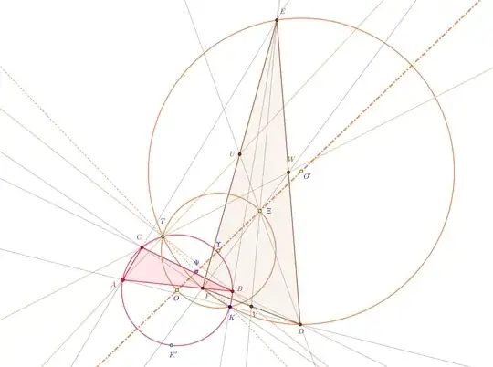

To avoid complicated computations, let us give a plain exact example with explicit numbers.
In the following picture we have $A,B,C=64,9,77$. The triangle $\Delta ABC$ has thus the sides $a,b,c=8,3,\sqrt {77}$.
mse 4848315
The values were chosen to have a small amount of square roots below, and are "random enough" to reveal optically only general geometric properties.
The chosen point $K$ that makes the corresponding $T$ land also on $(O)$ is $K=\frac1{53}(21 A+56B -24C)$. There is exactly one other point, that may have worked, $K'=\frac 14(8A+3B-7C)$ that may have also worked, but $K$ makes the picture more together.
The given triangle has area $S$ given by $S^2=s(s-a)(s-b)(s-c)=\frac1{16}(2AB+2BC+2CA-A^2-B^2-C^2) =\frac 1{16}(1152+1386+9856-4096-81-5929)=\frac 1{16}(2288)=143$. So $S=\sqrt {143}$. We compute the radius $R=abc/(4S)=\frac{6\sqrt{77}}{\sqrt{143}}$.
Similarly we can proceed for the triangle $\Delta DEF$. The sides are $EF=\sqrt{5376/11}$, $DF=\sqrt{756/11}$, $DE=14\sqrt 3$.
The corresponding area is $[DEF]=\sqrt{91728/11}$. And its circumradius is $R'=\frac{84\sqrt 3}{\sqrt{143}}$.
So we have the ratio of homothety $R/R'=\frac{\sqrt{11}}{2\sqrt{21}}$.
At last now, it is time to see that $\Delta ABC$ and $\Delta DEF$ are similar. (In geogebra one can show the angles, and there is a coincidence of values up to all shown decimal places.) This leads to the following Lemma.

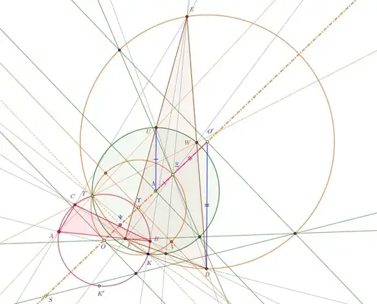

Lemma C: The points $UVWTK$ are on a circle. Let $\Lambda$ be its center. Then since $\Delta DEF$ and $\Delta UVW$ are similar w.r.t. the perspector $\Xi$ and factor $UV:DE=1:2$ we have $\Lambda,\Xi,O'$ collinear and $\Lambda\Xi:\Xi O'=1:2$.
Moreover, $O,\Upsilon$ complete the chain of rational proportions on the line $(L)=O\Upsilon\Lambda\Xi O'$: $$ O\Upsilon:\Upsilon\Lambda:\Lambda\Xi:\Xi O'=2:1:1:2\ . $$
mse 4848315 3
Proof: Skipped. (The equivalent non-trivial point is about the location of the center $O'$ of the circle $\odot(DEF)$, that given $O,\Xi$, arguably easier points, we have )
So far, all points that were introduced, excepting $O'$ are on the one or the other circle centered on a point on $(L)$, and orthogonal to $(L)$.
