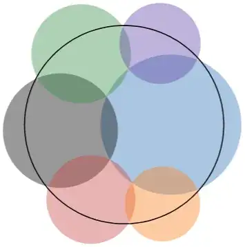

So far this is my best effort (the equations can be seen when you open the Desmos graph):
Approximately 99.96% of the big disk is covered. There are small gaps near the perimeter.
No matter how I arrange the disks, there always seems to be gaps. It seems impossible to cover the big disk, but I don't know how to prove it.

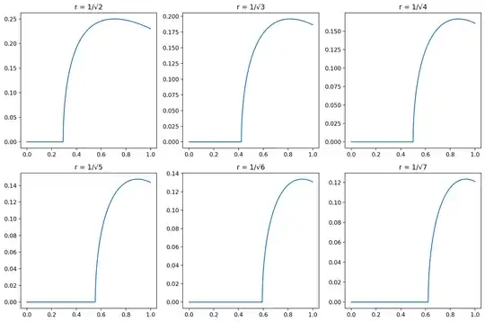

If we look at $x=1$, ie the perimeter of the disk, we can look at the fraction of perimeter covered by each disk as a function of $d$:
Adding up the maxima of these fractions for each $r\in R$ gives us a total covering fraction of $1.0173$, which doesn't rule things out as yet but suggests that we don't have much room to maneuver away from the perimeter.

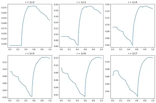

Generalizing a bit, we'll add three more rings, so we look at $X =[x_1,x_2,x_3,x_4=1]$. We'll then weight these rings by $W = [w_1,w_2,w_3,w_4]$, where we normalize $W$ to sum to $1$. If we can find values of $X$ and $W$ such that
$$\sum_{r\in R}\max_{d\in[0,1+r]}\left(\sum_{i=1}^4\frac{w_i}{\pi}\arccos\left(\frac{d^2+x_i^2-r^2}{2dx_i}\right)\right) < 1$$
then we'll know the problem is impossible, since in any valid solution the sum of covered fractions along each ring (and hence any weighted sum thereof) would need to exceed 1. (We could also think of this as using an equally-weighted sum across a 2D region, where we each turn each ring into an annulus of thickness $\epsilon w_i/x_i$ - for small enough $\epsilon$, this will have behavior arbitrarily close to the above setting.)
I fed this function into scipy.optimize.minimize with the constraint that all weights be nonnegative and it spit out the solution $X=[0.05,0.2384,0.3932,1], W=[0.01785, 0.04577, 0.02912, 0.90725]$. With these parameters the maximum weighted sum is around $0.999005$. The weighted scores for each disk as a function of $d$ are graphed below:

    By fiddling I found that X = [0.05, 0.24, 0.4, 1] and W = [0.02, 0.049, 0.03, 0.901] also works with sum about 0.9999916. – Lewis Baxter Jan 25 '24 at 15:50
    @Dan: Yes to your second question; for the first one, I was referring to tuning $W$, which can also be thought of as turning each 1D ring of radius $x_i$ and width $w_i$ into a very very thin 2D annulus with thickness $\epsilon w_i/x_i$ for some small epsilon and then weighting uniformly by area. I'll edit the post to make the wording clearer! – RavenclawPrefect Jan 25 '24 at 18:57
    @LewisBaxter yes; just choose some rational numbers very close to each $w_i$, then duplicate each ring so that the relative ratios work out. (If you want the rings to be distinct, you can of course add a very small perturbation to each ring by continuity.) – RavenclawPrefect Jan 25 '24 at 18:57

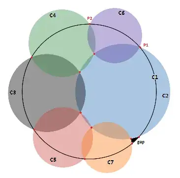

Here are some numerical results that suggest that the covering is impossible.
I wrote a program to generate points $P_1$ and $P_2$ and then successively construct all other points and circles as shown. One small gap remains.
Circle $C_1$ is $x^2+y^2 = 1$. Circle $C_2$ has centre $ (0.5 \pm \delta, 0 )$ - with $ \delta = 0.01$ - from which $P_1$ is constructed. $P_2 (x_2,y_2)$ is constructed with $ x_2 = \pm \delta$. All other points and circles are constructed in the order: $(C_6, C_4, C_3, C_5$ and $C_7)$.
After $10^9$ random generations the smallest gap found has an area of 0.1754% of the area of $C_1$.
The corresponding circle centres are: $ C_1 (0,0), C_2 (0.5009,0.0000), C_3 (-0.6327,-0.0210), C_4 (-0.4046,0.7151), C_5 (-0.3917,-0.6770), C_6 (0.3779,0.8310) \text{ and } C_7 (0.2589,-0.8278).$
