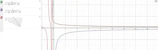

Well, strictly speaking, solving for the closed form of the continued fraction isn't that hard.
The closed form is given by $$\frac1{1+\overset{\infty}{\underset{n=1}{\large{\text{K}}}} \frac x1} = \frac1{1+\frac{2x}{\sqrt{4x+1}+1}} = \frac{\sqrt{4x+1}-1}{2x}$$
This can be found by solving for $y$ in the equation $y = \frac xy - 1$ and choosing to take the positive version by inspection (if anyone has a better method, please tell lol)
So, the integral just collapses into finding $$\int_0^\infty \frac{\sqrt{1+4x}-1}{2xe^x}\text{ d}x$$
Here, both Rubi and Mathematica cannot give the antiderivative, and I've not tinkered around with it much to be able to solve it analytically for now. Regardless, the definite integral is given by Mathematica to be $$\frac1{12}{}_2F_2\left(1, 1; 2, \frac52; \frac14\right) - \frac\pi2\operatorname{erfi}\left(\frac12\right) - 1 + \frac\gamma2 + e^{\frac14} \pi^{\frac12} \approx 0.68623$$ which matches the result you give.
