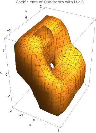

To generate a shape like this:
This is a sample image using the coefficients of a quadratic polynomial as 3D points.
When I change the bounds for $a, b, \text{or } c$, I get a similar shape where it is partially flat on the top and bottom, then curves. And it seems to have a flip symmetry.

So then what shape is formed that contains all the points (a, b, c) given the maximum and minimum bounds for each of those 3 parameters?

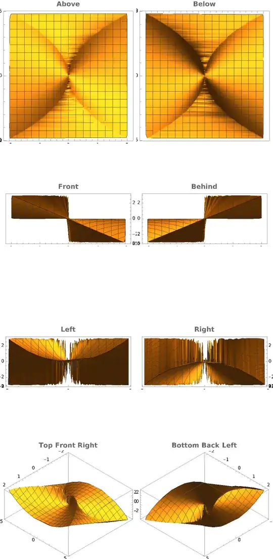

Here is the code and images for different viewpoints for when $b^{2} = 4ac$:

viewPoints = { {"Above", {0, 0, Infinity}}, {"Below", {0, 0, -Infinity}}, {"Front", {0, Infinity, 0}}, {"Behind", {0, -Infinity, 0}}, {"Left", {Infinity, 0, 0}}, {"Right", {-Infinity, 0, 0}}, {"Top Front Right", {Infinity, Infinity, Infinity}}, {"Bottom Back Left", {-Infinity, -Infinity, -Infinity}} };
plots = Table[ ListPlot3D[data, ViewPoint -> vp[[2]], ViewProjection -> "Orthographic", ImagePadding -> 5, PlotLabel -> Style[vp[[1]], 14, Bold, Background -> White], PlotRangePadding -> 0.2 ], {vp, viewPoints} ];
(* Adjust the size of the graphics grid as needed *) Rasterize[GraphicsGrid[Partition[plots, 2], Spacings -> {0, 0}, ImageSize -> Full]]
Which gave the example image:
This is a sample plot from 8 different orthographic view points.

    suggest you get the best images you can of the (elliptical) cone $b^2 = 4ac$ Let me see if I have any way to show that...maybe not. Anyway, the positive definite forms are "inside" the (double-nappe) cone, the negative forms in the opposite piece, and the indefinite forms in the funny donut shape – Will Jagy Jan 10 '24 at 01:59

    An indefinite, but non-degenerate, quadratic form in three variables has a zero set that is an elliptical cone, or a circular cone, double napped and through the origin. You might ask for images of $z^2 - x^2 - y^2 = 0$ and then $z^2 - 2x^2 - y^2 = 0$ – Will Jagy Jan 10 '24 at 02:55
  • @WillJagy I updated it to show when $b^{2} = 4ac$ from different view points. – Teg Louis Jan 12 '24 at 03:48
