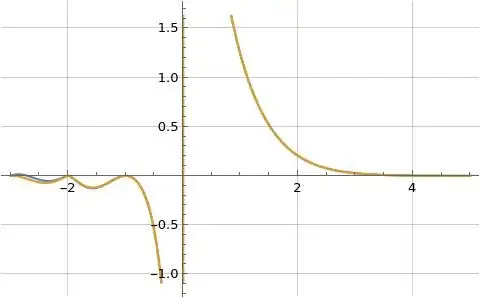

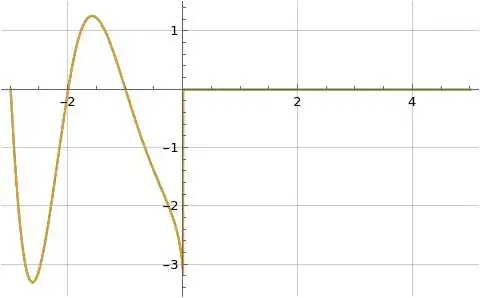

Figures (1) and (2) below illustrate the real and imaginary parts of formula (2) for $G(s)$ above evaluated at $N=100$ and $N=1000$ in blue and orange respectively. Note $G(s)$ seems to have a pole at $s=0$, converge to zero as $s\to\infty$, and typically has both imaginary and real components when evaluated for $s<0$, but seems to evaluate to zero at negative integer values of $s$ consistent with the table above. I'm not sure if formula (2) for $G(s)$ above is globally convergent, but it if is evaluations seem to indicate it converges more slowly for $\Re(s)<0$ than for $\Re(s)>0$.
Illustration of real part of formula (2) for G(s)
Figure (1): Illustration of real part of formula (2) for $G(s)$ evaluated at $N=100$ and $N=1000$ in blue and orange respectively
Illustration of imaginary part of formula (2) for G(s)
Figure (2): Illustration of imaginary part of formula (2) for $G(s)$ evaluated at $N=100$ and $N=1000$ in blue and orange respectively

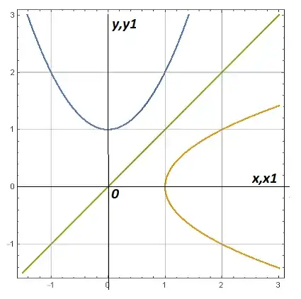

An attempt made here is by using simple calculus.
A simple parabola function and its inverse function in order to outline the steps is included.
$$y= 1+x^2,~ y'= 2x,~\text{first order derivative reciprocal and }$$
by variables swap $ y'\to 1/y',~ x\to y $
$$ \frac{1}{y'}=2y~; \frac {dx}{dy}=2y~, $$
Relabeling for inverse function,
$$ \frac {dx1}{dy1}=2y1~;$$
Integrate
$$ x1=y1^2 + c,$$
with Boundary conditions $ (x1=1, y1=0 \to c=1~) $
$$x1=y1^2+1~, y1=\sqrt{x1-1}~$$
The inverse function is gray, parabola symmetrical to the x-axis, inverse functions always reflect about straight line $x=y.$

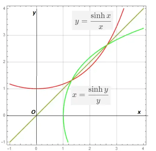

We adopt exactly the same procedure for obtaining the inverse function of the given (red curve) function.
$$ y=\frac{\sinh x }{x} $$
Differentiate to find ode
$$\frac{dy}{dx} =\left(\frac{x \cosh x-\sinh x}{x^2}\right); $$
Interchanging variables
$$\frac{dx}{dy} =\left(\frac{y \cosh y-\sinh y}{y^2}\right); $$
Relabel for inverse function clear identification:
$$\frac{dx1}{dy1} =\left(\frac{y1 \cosh y1-\sinh y1}{y1^2}\right); $$
The RHS is seen to be (by inspection) directly the full derivative of $\left(\dfrac{\sinh y1}{y1}\right) $ with respect to $y1$ by the Quotient Rule of differentiation
$$ \frac{dx1}{dy1}=d\left(\frac{\sinh y1}{y1} \right)/dy1 ; $$
Integrating
$$ x1=\frac{\sinh y1}{y1} + C_1 $$
Boundary condition $x1=1,y1=0\to C_1=0,$ using L'Hospital's Rule
$$ \boxed{x1=\left(\frac{\sinh y1}{y1}\right) } $$
which is the equation of the sketched (green ) inverted function curve in closed form, reflected about the straight line $x=y$.
