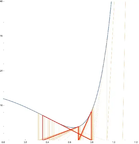

Here is a plot of the function $$f(x) = 49 x^7+31 x^6-10 x^5-41 x^4+37 x^3-21 x^2-9 x+12$$ in the region of interest. The blue curve is $f$. The orange lines represent the forward orbit of $x_0 = \pi$ under $x \mapsto x - f(x)/f'(x)$, connecting $(x_i, f(x_i))$ to the next iterate $(x_{i+1}, 0)$, then to $(x_{i+1}, f(x_{i+1}))$, and so forth. Note that the initial iterations are not shown because the value of the function at these points is large.
The thick red line shows the steady-state behavior of the orbit, and we can see this will converge to a $3$-cycle of values, which are approximately $$S = \{0.355634, 0.796309, 0.680185\}.$$
This suggests that for any $x \in S$, the rational function $$g(x) = x - \frac{f(x)}{f'(x)} = \frac{294 x^7+155 x^6-40 x^5-123 x^4+74 x^3-21 x^2-12}{343 x^6+186 x^5-50 x^4-164 x^3+111 x^2-42 x-9}$$ satisfies $$g(g(g(x))) = x.$$
Indeed, we can hypothesize that whenever $f$ has a neighborhood with a local minimum but no root, then there is the possibility of an initial choice $x_0$ for which the forward orbit does not converge to a root.

  • After a bit more experimentation, it seems that this iteration does not actually converge to either of the two possible 3-cycles, as all of these points are unstable in their neighborhoods. $\left|\frac{d}{dx} g(g(g(x)))\right|>1$ for all of them. Instead it moves chaotically in the range (but not the entire range). You can even see this in your image, as points in the neighborhood of the second point are more spread out around the first after 1 iteration. – Tbw Jan 09 '24 at 08:26
  • @Tbw You're right--after plotting a histogram of $10^6$ iterates, it does appear to be chaotic. There is a distribution of values around each of the three neighborhoods that doesn't settle down. – heropup Jan 09 '24 at 10:35

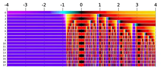

This won't occur for polynomials of degree less than 3, but it may occur for cubic polynomials like $$ p(z) = z^3-2z+2 $$ The dynamics of the Newton process $z\mapsto {\cal N}_p(z)$ is made visible by the graphic below which displays the dynamic for real starting values with $z\in[-4,4]$.
The image consists of 18 colored stripes, each color encoding a real number (−4=purple, −2=violet, −1=cyan, 0=black, 1=red, 2=orange, 4=yellow, ±∞=white). From top to bottom, the stripes show values of the $n$-th Newton iterate, where row 0 indicates the starting values.
Starting values smaller than approximately −0.83 converge to the violet zero of $p(z)$ at $z\approx-1.76929$, but all values in some interval around $0$ are attracted by the black-red cycle $$\cdots0\mapsto 1\mapsto 0\mapsto 1\mapsto 0\mapsto1\cdots$$

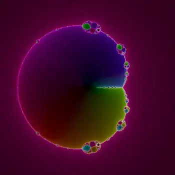

For cubic polynomials one can study the behavior of the critical point of ${\cal N}_p$. For example, $0$ is a critical point of ${\cal N}_{p_\lambda}$ for all cubics from the family $$ p_\lambda(z) = z^3+(\lambda-1)z-\lambda $$ Plotting how the critical point of ${\cal N}_{p_\lambda}$ behaves under iteration gives the following result, where $\lambda$ ranges over the complex plane where $-2.5\leqslant Re(\lambda),Im(\lambda)\leqslant 2.5$.
There are tiny black spots that are subsets of full measure in the $\lambda$ space for which the critical point does not converge to a zero of $p_\lambda$.

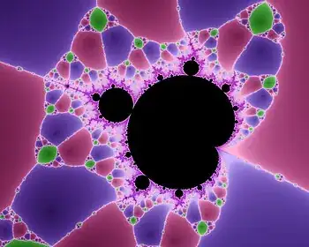

Magnifying the black spot around $\lambda\approx0.3+1.64i$ looks like this:
There are infinitely many of such black islands of full measure.
Answer to a comment: The hue in the last two images represents the limit of $$\lim_{n\to\infty} {\cal N}_{p_\lambda}^n(0)$$ i.e. the fate of the critical point 0 of ${\cal N}_{p_\lambda}$ under iteration, provided the iteration converges. When it does not converge, then the point at $\lambda$ is colored in black. There are 3 hues around the island in the 3rd image because $p_\lambda$ has 3 complex zeros that may occur as limit. The hue indicates which zero and relates to the limit in a non-obvious way and such that the 3 hues are 120° apart in color space (red, green, blue). This comes with a grain of salt because the exact locations of the zeros of $p_\lambda$ depend on $\lambda$, so this only holds approximately and only is small regions. It's the reason for why the colors of the zeros in the overview picture transition smoothly over large stretches of the $\lambda$ plane.
The brightness indicates how many iterations where required to conclude that the iteration converges for that $\lambda$: brighter = more. For points close to the Mandelbrot islands, the saturation is increased again before it finally drops to white. This is for aesthetical reasons and results in the purple-white glow around the black islands.
The algorithm smoothes out the colors by interpolating the number of iterations (which are natural numbers) to real numbers; similar to how you would smooth the potential around an electrically charged Mandelbrot set. To that end, one has to introduce a notion of distance to the closest complex root of $p_\lambda$.
It's more than 10 years ago since I make these images; so bear with me. The summary of the wiki page contains and explains the relevant part of the C code I used back then. The idea for this specific family of cubics is from the book of Peitgen and Richter.
