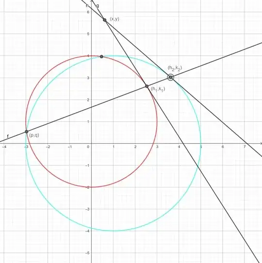

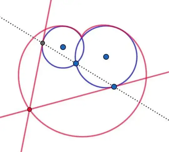

About 8 months ago I came up with this nice feature using GeoGebra but I couldn't prove it, any help would be appreciated
We have two intersecting circles and we drew the moving line passing through one of the two intersection points, then we drew the tangents to the two circles at the ends of its intersection with the two circles and set the red point that represents the point of intersection of the two tangents. What I arrived at is that the traces of the red point will create a cardiac curve whose head is the other point of intersection of the two circles and touches both circles.

  • Nice, though I cannot seem to reproduce the curve between the two directions where the dotted line sits along the direction of one of the red tangent lines. Between those directions the two tangent lines become parallel and the trace point disappears in that region (on my graphic) – Paul Jan 06 '24 at 10:22
  • The state of contact is considered to be a borderline state of the shape in which the two lines are lined up, but it can be seen that the contact is very close before that, and thus we can conclude that the state of contact is what the shape will be like in the place where the two lines meet, and this happens at the tangents of the two circles at the point of intersection that we started with. Of which – زكريا حسناوي Jan 06 '24 at 10:31

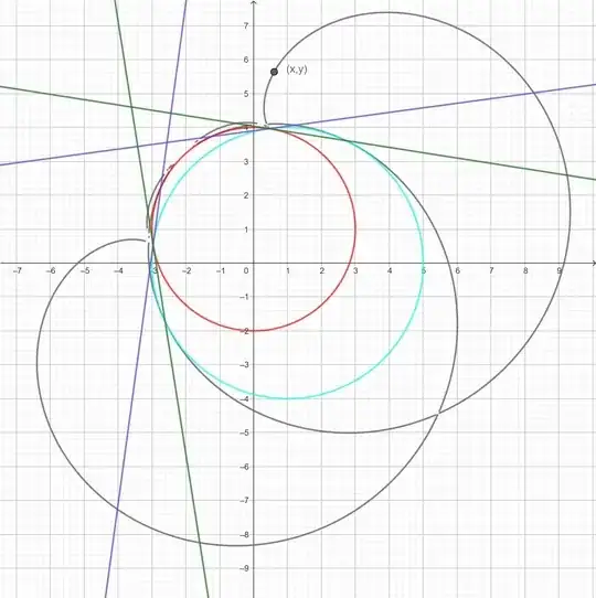

  • The two cardioids
    In M2 using $C_1: x^2+(y-1)^2=3^2$ and $C_2: (x-1)^2+y^2=4^2$ not choosing which intersection point $(p,q)$ to use and with $(h_1,k_1),(h_2,k_2)$ the tangent points for $C_1,C_2$ resp. with $(p,q), (h_1,k_1),(h_2,k_2)$ on a line we get one equation over ${\Bbb Q}$ for both cardioids combined and also two line pairs symmetric about the situation.

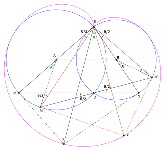

EDIT. I completely revised my answer, because I found a simpler approach.
Let the centers of the circles (blue in figure below) be $A$, $B$ and let $D$, $E$ be their intersection points. Construct diameters $EM=a$ and $EN=b$ as in the figure. Line $MN$ is parallel to $AB$ and passes through $D$ (because $AB$ intersects $ED$ at the midpoint of $ED$). Hence point $P$, intersection of the tangents at $M$ and $N$, belongs to the locus described in the answer.
Consider now another point $M'$ on the circle with center $A$ and its companion $N'$ on the circle with center $B$, such that line $M'N'$ passes through $D$. If we set $$ \angle MAM'=\theta $$ then $$ {\theta\over2}=\angle MEM'=\angle MDM'=\angle NDN'=\angle NEN'. $$ Quadrilateral $EM'P'N'$ is then cyclic, because: $$ \angle EM'P'={\pi\over2}-{\theta\over2},\quad \angle P'N'E={\pi\over2}+{\theta\over2} $$ and its circumradius is $$ r={M'N'\over2\sin\phi}, $$ where $\phi=\angle M'EN'=\angle MEN$. Hence: $$ EP'=2r\sin{\pi+\theta\over2}={M'N'\over\sin\phi}\cos{\theta\over2}. $$ But triangles $M'EN'$ and $MEN$ are similar, because they have the same angle at vertex $E$ and $EM'/EM=EN'/EN=\cos{\theta\over2}$, hence: $$ M'N'=MN\cos{\theta\over2}. $$ We have then: $$ EP'={MN\over\sin\phi}\cos^2{\theta\over2} ={MN\over2\sin\phi}(1+\cos\theta), $$ which is just the polar equation of a cardioid, if we take ray $EP$ as reference axis. In fact we have $\angle ′=$ because both tangents $′′$ and $′′$ are rotated by $$ with respect to $$ and $$.
Hence the locus of $P'$ is a cardioid, as it was to be proved. Note that $MN/(2\sin\phi)$ is the circumradius of triangle $EMN$, that is twice the circumradius of triangle $EAB$.
In the light of the last remark above, we can check that $P'$ is also the locus traced by a point on the perimeter of a circle, that is rolling around a fixed circle of the same radius (see the definition of cardioid). The fixed circle is the circumcircle of $AEB$, with center $O$ and radius $OE$. The rolling circle (red in figure below) starts with a diameter aligned with $EO$, ending at $P$.
If the red circle is rolled by an angle $\theta$, then point $P$ is carried to $P'$ and it is easy to prove that $\angle PEP'=\theta$ (because $EOCP'$ is a trapezoid) and $$EP'=2OE(1+\cos\theta),$$ the same result we got above.

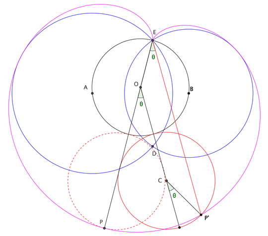

My answer has different levels.
First idea : A reformulation of the question under a generalized form.
Fot this, we need to introduce the lemniscate with polar/implicit equations :
$$r=1-\cos \theta \ \iff \ (x^2+y^2+x)^2=x^2+y^2 \tag{1}$$
right at the beginning ; then we need to consider/remember one of the numerous modes of generation of the cardioid as the envelope of circles $(C_a)$ (see left figure) passing through its apex with polar/implicit equations
$$(C_a): \ \ r=\cos(\theta-a)-\cos(a) \ \iff \ x^2+y^2+(1-\cos a)x-(\sin a)y=0$$
In this perspective, I propose a generalization of the initial issue :
Modified objective : Show that, if one takes any point $L$ on the cardioid, and any pair of circles $(C_a),(C_{a'})$, the external tangents issued from $L$ to these circles are such that their points of tangency are aligned with the point of intersection $I$ of $(C_a)$ and $(C_{a'})$ different from the origin (materialized by a little red circle).

Fig. 1 : (reminds the rings of Olympic Games...) LHS: the initial (generalized) situation. RHS : the image of the LHS figure by the inversion transform (inversion circle in green).

In M2 using $C_1: p^2+(q-1)^2=3^2$ and $C_2: (p-1)^2+q^2=4^2$ not choosing which intersection point $(p,q)$ to use and with $(h_1,k_1),(h_2,k_2)$ the tangent points for $C_1,C_2$ resp. with $(p,q), (h_1,k_1),(h_2,k_2)$ on the line $\begin{vmatrix}p&q&1\\h_1&k_1&1\\h_2&k_2&1\end{vmatrix}=0$ and finally the two tangents at $(h_1,k_1),(h_2,k_2):$ $$2h_1(x-h_1)+2(k_1-1)(y-k_1)=0,\\2(h_2-1)(x-h_2)+2k_2(y-k_2)=0$$ defining the point $(x,y)$ we want:
R=QQ[h1,k1,h2,k2,p,q,x,y,MonomialOrder => Eliminate 6]
I=ideal(p^2+(q-1)^2-3^2,(p-1)^2+q^2-4^2,h1^2+(k1-1)^2-3^2,(h2-1)^2+k2^2-4^2,determinant matrix({{p,q,1},{h1,k1,1},{h2,k2,1}}),2*h1*(x-h1)+2*(k1-1)*(y-k1),2*(h2-1)*(x-h2)+2*k2*(y-k2))
gens gb I;
toString factor oo_0_0
we get a combined equation over ${\Bbb Q}$ of degree $8=2\cdot 4$ for both cardioids defined much like the two line pairs of degree $2\cdot 1$ of tangents to the circles about the intersection points between the circles (in that to factor further, we step out of ${\Bbb Q}$).
The two cardioids
