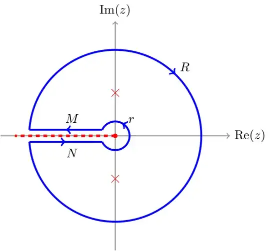

We prove this by computing the integral in anther way. First observe that by substituting $x=\frac 1u$, we get $$I = \int_1^\infty \frac{\ln(u)^4}{1+u^2} du$$ Therefore $$I = \frac{1}{2}\int_0^\infty \frac{\ln(x)^4}{1+x^2} du$$
We can solve this with contour integration. Consider the integral of $f(z)=\frac{A\log(z)^5+B\log(z)^3+C\log(z)}{z^2+1}$ over the keyhole contour. Here $\log$ is taken to have a branch cut on the negative real line.
The keyhole contouri
Using standard $ML$ lemma arguments, one can show that the circular arcs of the contour vanish in the $R\to \infty$ and $r\to 0$ limits. Therefore, the only two contributions come from the $M$ and $N$ contours.
We can directly parameterize the $M$ and $N$ contour with $z = -t+i\epsilon$ and $z=-t-i\epsilon$ for $0<t<\infty$, respectively. As $\epsilon$ approaches zero, notice that the branch cut causes $\log(z)$ to approach different values. It approaches $ln(t)+i\pi$ on $M$ and $\ln(t)-i\pi$ on $N$.
The contour integral becomes $$\oint_\gamma f(z)dz = \oint_M f(z)dz+\oint_N f(z)dz $$$$=\int_0^\infty \frac{A(\ln(t)+i\pi)^5+B(\ln(t)+i\pi)^3+C(\ln(t)+i\pi)}{1+t^2}dt -\int_0^\infty \frac{A(\ln(t)-i\pi)^5+B(\ln(t)-i\pi)^3+C(\ln(t)-i\pi)}{1+t^2}dt$$
Now, the odd powers of $\ln(t)$ cancel and we are left with only the even powers. $$=\int_0^\infty \frac{ 10 π A \ln(t)^4i+ 2 \pi (3 B - 10 \pi^2 A) \ln(t)^2i+ 2 \pi (\pi^4 A - \pi^2 B + C)i}{1+t^2}dt $$
By matching the coefficients in the powers of $\ln(t)$, we now can solve a linear system to find the values of $A,B,C$ such that this contour integral is equal to $I$ and get $A = -\frac{1}{20\pi}i$, $B=-\frac{\pi}6i$ and $C=-\frac{7}{60}\pi^3i$.
On the other hand, we can use the residue theorem to compute to contour integral. We have two simple poles at $\pm i$ with the following residues:
$$\mathrm{Res}(f,i)=\frac{A\log(i)^5+B\log(i)^3+C\log(i)}{2i}=-\frac{5\pi^4}{256}i$$
$$\mathrm{Res}(f,-i)=\frac{A\log(-i)^5+B\log(-i)^3+C\log(-i)}{-2i}=-\frac{5\pi^4}{256}i$$
We can now compute $I$ as
$$I = \int_\gamma f(z)dz= 2\pi i (\mathrm{Res}(f,i)+\mathrm{Res}(f,-i))$$ $$ \implies I = 4\pi i (-\frac{5\pi^4}{256}i) = \frac{5\pi^5}{64} $$
Q.E.D.
