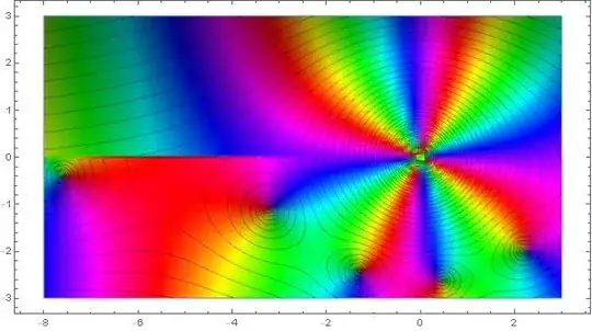

$$\frac{H_{v}^{1}\left( bu \right)}{H_{v}^{1}\left( au \right)}\sim \frac{{{a}^{v}}}{{{b}^{v}}} \> as \> \left| u \right|\to 0$$ and $$\frac{H_{v}^{1}\left( bu \right)}{H_{v}^{1}\left( au \right)}={{e}^{i\left( b-a \right)u}}\sqrt{\frac{a}{b}}\left( 1+O\left( {{\left| u \right|}^{-1}} \right) \right) \> as \> \left| u \right|\to \infty $$ Therefore consider a contour consisting of the real line, indented above z=0 with a small semi-circle of radius $\delta $, and a large semi-circle of radius R in the upper half plane. Therefore $$\int\limits_{C}^{{}}{\frac{H_{v}^{1}\left( bz \right)}{H_{v}^{1}\left( az \right)z}dz}=\int\limits_{R}^{{}}{{}}+\int\limits_{-\infty }^{\infty }{{}}+\int\limits_{\delta }^{{}}{{}}=0$$ and hence $$\int\limits_{-\infty }^{\infty }{\frac{H_{v}^{1}\left( bu \right)}{H_{v}^{1}\left( au \right)u}du}=\frac{\pi i{{a}^{v}}}{{{b}^{v}}}$$ Here the integral is understood to be a principal value. Note the following properties $${{Y}_{v}}\left( z{{e}^{m\pi i}} \right)={{e}^{-vm\pi i}}{{Y}_{v}}\left( z \right)+2i\sin \left( vm\pi \right)\cot \left( v\pi \right){{J}_{v}}\left( z \right)$$ $${{J}_{v}}\left( z{{e}^{m\pi i}} \right)={{e}^{-vm\pi i}}{{J}_{v}}\left( z \right)$$ From which it is noted $$H_{v}^{1}\left( -z \right)={{J}_{v}}\left( -z \right)+i{{Y}_{v}}\left( -z \right)=-{{\left( -1 \right)}^{v}}{{J}_{v}}\left( z \right)+{{\left( -1 \right)}^{v}}\left( i{{Y}_{v}}\left( z \right) \right)={{\left( -1 \right)}^{v-1}}\left( {{J}_{v}}\left( z \right)-i{{Y}_{v}}\left( z \right) \right)={{\left( -1 \right)}^{v-1}}H_{v}^{2}\left( z \right)$$ From this we break the integral in two, i.e. $$\int\limits_{-\infty }^{\infty }{\frac{H_{v}^{1}\left( bu \right)}{H_{v}^{1}\left( au \right)u}du}=-\int\limits_{0}^{\infty }{\frac{H_{v}^{1}\left( -bu \right)}{H_{v}^{1}\left( -au \right)u}du}+\int\limits_{0}^{\infty }{\frac{H_{v}^{1}\left( bu \right)}{H_{v}^{1}\left( au \right)u}du}$$ Or using the results above $$\int\limits_{-\infty }^{\infty }{\frac{H_{v}^{1}\left( bu \right)}{H_{v}^{1}\left( au \right)u}du}=\int\limits_{0}^{\infty }{\frac{H_{v}^{1}\left( bu \right)H_{v}^{2}\left( au \right)-H_{v}^{2}\left( bu \right)H_{v}^{1}\left( au \right)}{H_{v}^{1}\left( au \right)H_{v}^{2}\left( au \right)u}du}$$ Simplifying this one obtains $$\int\limits_{-\infty }^{\infty }{\frac{H_{v}^{1}\left( bu \right)}{H_{v}^{1}\left( au \right)u}du}=2i\int\limits_{0}^{\infty }{\frac{{{J}_{v}}\left( au \right){{Y}_{v}}\left( bu \right)-{{J}_{v}}\left( bu \right){{Y}_{v}}\left( au \right)}{\left( J_{v}^{2}\left( au \right)+Y_{v}^{2}\left( au \right) \right)u}du}$$ Finally $$\int\limits_{0}^{\infty }{\frac{{{J}_{v}}\left( au \right){{Y}_{v}}\left( bu \right)-{{J}_{v}}\left( bu \right){{Y}_{v}}\left( au \right)}{\left( J_{v}^{2}\left( au \right)+Y_{v}^{2}\left( au \right) \right)u}du}=\frac{\pi {{a}^{v}}}{2{{b}^{v}}}$$
