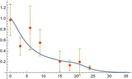

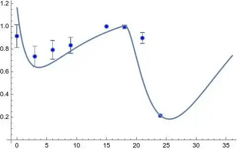

Changing the wheighting factor to k^alpha as can be depicted in the function fitness we can obtain a solution to the odes with the positive requirement.
fitness[a00_?NumberQ, c00_?NumberQ, d00_?NumberQ, s0_?NumberQ, b0_?NumberQ] := Module[{ss, bb, parms, odes, ODES, solode, cinits, ssbb, t, alpha = 1.1},
  odes = {ss'[t] + a00/(1 + bb[t]) ss[t] - 0.31 ss[t] (1 - ss[t]/6.19) == 0, bb'[t] - c00 (1 - bb[t]) + d00 bb[t] ss[t] + 3 c00 (1 - bb[t - 18]) == 0};
  cinits = {ss[t /; t <= 0] == s0, bb[t /; t <= 0] == b0};
  ODES = Join[odes, cinits];
  solode = Quiet@NDSolve[ODES, {ss, bb}, {t, tk[[1]], tk[[8]]}][[1]];
  Return[Sum[Norm[{y1[[k]], k^alpha y2[[k]]} -
  Evaluate[{ss[t], k^alpha bb[t]} /. solode /. {t -> tk[[k]]}]], {k, 1, 8}]]]
tk = {0, 3, 6, 9, 15, 18, 21, 24}; y1 = {0.974, 0.492, 0.829, 0.554, 0.208, 0.138, 0.199, 0.0893}; y2 = {0.915094, 0.736097, 0.793694, 0.833664, 1, 0.99578, 0.897964, 0.214499}; SdatawithSD = {{0, Around[0.974, 0.289]}, {3, Around[0.492, 0.165]}, {6, Around[0.829, 0.404]}, {9, Around[0.554, 0.245]}, {15, Around[0.208, 0.191]}, {18, Around[0.138, 0.0962]}, {21, Around[0.199, 0.241]}, {24, Around[0.0893, 0.0359]}}; BdatawithSD = {{0, Around[0.915094, 0.1]}, {3, Around[0.736097, 0.091668]}, {6, Around[0.793694, 0.082575]}, {9, Around[0.833664, 0.070242]}, {15, Around[1, 0.002851]}, {18, Around[0.99578, 0.015591]}, {21,Around[0.897964, 0.04783]}, {24, Around[0.214499, 0.01231]}};
restrs = {0.7 - 0.2 < a00 < 1 + 0.2 && 0.1 < c00 < 0.5 + 0.2 && 0.1 < d00 < 0.5 + 0.2 && 0.9 - 0.2 < s0 < 1.2 + 0.2 && 0.9 - 0.2 < b0 < 1.2 + 0.2}; vars = {a00, c00, d00, s0, b0};
sol = Quiet@NMinimize[Join[{fitness[a00, c00, d00, s0, b0]}, restrs], vars, StepMonitor :> Print[{a00, c00, d00, s0, b0, fitness[a00, c00, d00, s0, b0]}], MaxIterations -> 10, WorkingPrecision -> 30, Method -> "DifferentialEvolution"]
odes = {ss'[t] + a00/(1 + bb[t]) ss[t] - 0.31 ss[t] (1 - ss[t]/6.19) == 0, bb'[t] - c00 (1 - bb[t]) + d00 bb[t] ss[t] + 3 c00 (1 - bb[t - 18]) == 0} /. sol[[2]]; cinits = {ss[t /; t <= 0] == s0, bb[t /; t <= 0] == b0} /. sol[[2]]; ODES = Join[odes, cinits]; solode = NDSolve[ODES, {ss, bb}, {t, tk[[1]], 1.5 tk[[8]]}][[1]];
g11 = ListPlot[SdatawithSD, PlotStyle -> {Orange, PointSize[0.02]}, AxesOrigin -> {-1, 0}]; gr10 = ListPlot[Transpose[{tk, y1}], PlotStyle -> Red, PlotLabel -> "S(t)"]; gr0 = Plot[Evaluate[ss[t] /. solode], {t, tk[[1]], 1.5 tk[[8]]}]; Show[g11, gr10, gr0, PlotRange -> All]
g22 = ListPlot[BdatawithSD, AxesOrigin -> {-1, 0}, PlotStyle -> {PointSize[0.02]}]; gr2 = ListPlot[Transpose[{tk, y2}], PlotStyle -> Blue]; gr00 = Plot[Evaluate[bb[t] /. solode], {t, tk[[1]], 1.5 tk[[8]]}]; gr02 = ListPlot[Transpose[{tk, y2}], PlotStyle -> Blue, PlotLabel -> "B(t)"]; Show[g22, gr02, gr00, PlotRange -> All]
