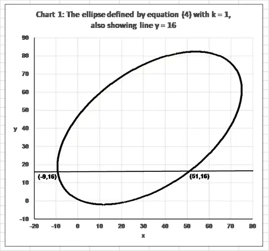

As an illustration, if $k=1$ and $(x_0,y_0)=(-9,16)$, equation (5) becomes:
$$x^2 + \big(-1(16) –(27-1) \big)x + \big(16^2 – (27+18+2)16 + (27 + 9 +1 \big) = 0\tag7$$
which simplifies to:
$$x^2 -42x - 459 = 0\tag8$$
yielding $(x_1,y_1)=(51,16)$ as a new solution of (4). The two solutions are at the intersections of the ellipse and the horizontal line $y=16$ as shown in Chart 1.
Chart 1
This procedure can be repeated by substituting $x_1$ into (4) and solving in the same way the resulting quadratic equation in $y$ to obtain a further integer solution of (4) which will lie on the intersection of the ellipse with a vertical line through $(x_1,y_0)$. And there is no need to stop there: we can proceed indefinitely, at each iteration substituting into (4) the new value of $x$ or $y$ obtained at the previous iteration. Starting from $(-9,16)$, this yields the sequence of solutions $(-9,16),(16,51),(51,82),(82,57),(57,22),(22,-9),\dots$.

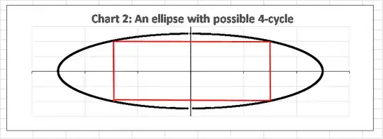

III. A third consideration is that the configuration of the ellipses defined by equation (4) is conducive to cycles of 6 points, rather than some other number of points. Intuitively, the number of points that can form a cycle linked by alternate horizontal and vertical lines within an ellipse is related to a) the direction of the axes, and b) its eccentricity, one indicator of which is the ratio of the major to the minor axis.
If the axes are horizontal and vertical, a 4-cycle is always possible as in Chart 2 below. Note that it is not claimed that any ellipse must pass through at least one integer point, nor that if it does then another such point must lie on the intersection of the ellipse with a horizontal or vertical line throught the first point. The purpose of Charts 2 and 3 is to show that, if those conditions are met, the number of points in the resulting cycles will depend on the configuration of the ellipse.
Chart 2

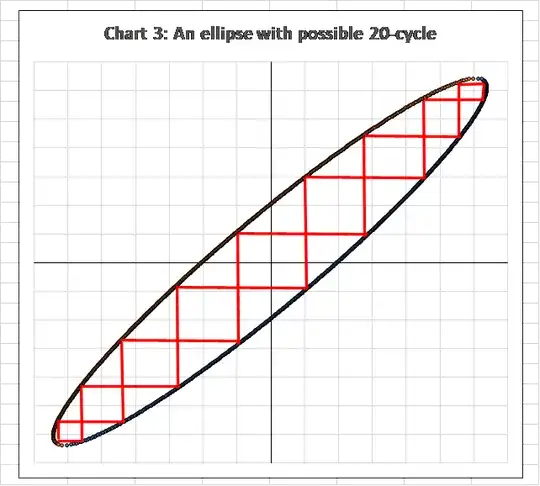

If the axes are at $45^{\circ}$ to the horizontal, then a high degree of eccentricity will require a cycle with a large number of points, as in Chart 3 below in which the ratio of the axes is about $6$:
Chart 3

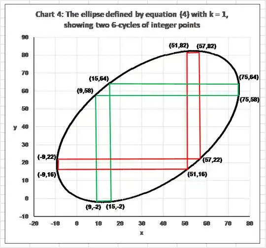

I am not aware of a precise formula relating the cycle size to the degree of eccentricity of an ellipse with axes at $45^{\circ}$ to the horizontal, but having seen the example of the ellipse in Chart 3 it seems unsurprising that ellipses with an axis ratio of $\sqrt{3}$, ie moderately eccentric, should generate 6-cycles, two of which from the question are illustrated below:
Chart 4
Each of the two cycles is the mirror image of the other, the axis of symmetry being the line $y=x+7$ which coincides with the major axis of the ellipse.

  • +1 Beautiful! I knew there had to be a underlying reason behind the cycles. Chart 4 is especially nice, to see those numbers in a geometric context. – Tito Piezas III Dec 20 '23 at 06:37
  • In fact, I found four families with a 6-cycle, though i only put the first family in the post to prevent clutter. These families have a common feature which might explain why they exist. I will post them shortly. – Tito Piezas III Dec 20 '23 at 08:02
  • I made some minor changes to improve flow. A favor though. Chart 4 is the first set (−9,16,51,82,57,22). Can you make a Chart 5 showing the second set (15,−2,9,58,75,64)? It would be nice to see how similar they look. – Tito Piezas III Dec 22 '23 at 04:00
