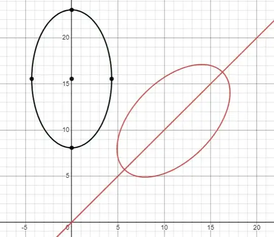

For $a$ fixed we have an ellipse whose semi-axes measure, $\sqrt{56}$ the largest (located at the diagonal) $y=x$, and $\sqrt{\dfrac{56}{3}}$ the smallest. When $a$ changes the ellipse simply moves along the diagonal $y=x$.

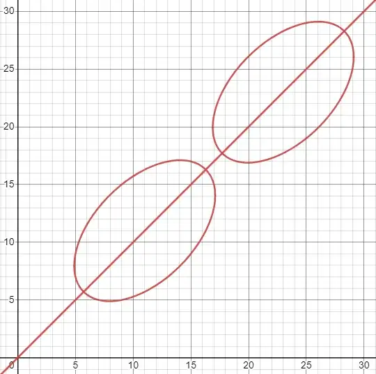

In the attached figure it is shown first the original ellipse (in red) and its normal form (in black) when $a=11$ and second, two ellipses in the original form for the values $a=11$ and $a=23$ (in this second figure the scala has been changed in order to have the figure well set up) enter image description here

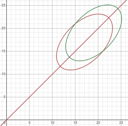

We take as examples of the approximation to the method we want to apply, two ellipses corresponding to the values $a=17,19$ (we already know that the two ellipses have the same size;look at the figure below).
For $a=17$ (red in the figure ) one has the six integer solutions $(a,b,c)=\boxed{(17,23,11)},(17,15,11),\boxed{(17,13,19)},(17,21,15),\boxed{(17,23,19)},(17,21,23)$ (there are more all just changing $(b,c)$ by $(c,b))$ where three of them are prime so solutions of the problem.
For $a=19$ (green in the figure) we have the six integer solutions $(a,b,c)=(19,15,13),\boxed{(19,17,13)},(19,21,15),\boxed{(19,23,17)},(19,25,21),(19,25,23)$ (there are more all just changing $(b,c)$ by $(c,b))$ where two of them are prime so solutions of the problem. enter image description here
