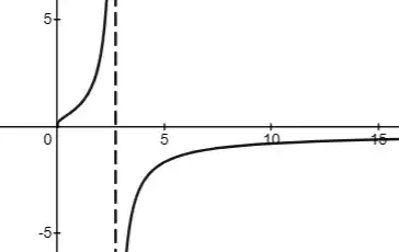

Here is the graph of $y=\frac{1}{1-\ln x}$.
I don't know any method other than trial and error. I've plugged into Wolfram various $(a,b)$ without success: $(0,1), (0,\frac{1}{e}), (0,\sqrt{e}), (e^2, e^3)$, etc.

    I guess it's not easy to find such numbers. I'd start with $(e, +\infty)$ and represent the integral as series. – openspace Nov 16 '23 at 10:29

  • Expanding more on @openspace 's comment, the only way I can seem to thing about this question is to represent it as a series and give approximate solutions approaching it's asymptotes, it should look something like this, $\int\frac{1}{1-\ln x}dx = \sum_ {}\int (1-lnx)^n dx$ , I'm pretty sure this is outside the scope of an high school education though. – Amy Skinner Nov 17 '23 at 01:00

  • @AmySkinner firstly, it's better to start with change of variables (because Taylor for $\log (1 + x)$ is only for $|x| < 1$). Secondly, I have a doubt that high schoolers are familiar with integration in general. At least in my country, we dealt with it at the the end of the school. – openspace Nov 17 '23 at 09:07
  • Just and idea (assuming $b < e$ and $a > e^{-1}$):
    $$ \int_a^{b} \frac{1}{1 - \log x} dx = \int_{\log a}^{\log b} \frac{e^x}{1 - x} dx = \sum_{k \ge 0} \sum_{m \ge 0} \int_{\log a}^{\log b} \frac{x^{m + k}}{k!} dx $$. For symmetric parts ($e^{-1}$ and $e$ f.e.) we can notice that most of the parts eliminate.
    – openspace Nov 17 '23 at 09:26
