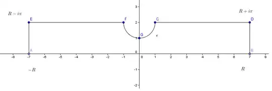

By contour, take the path as
$$-R \to R \to R + i\pi \to \epsilon + i \pi \to \gamma \to -\epsilon + i \pi \to -R+ i \pi \to -R $$ enter image description here The integral is $$\int_{-R}^R \frac{x}{\sinh(x)}dx +\int_0^{\pi} \frac{R + i y}{\sinh(R + iy )}i dy + \int_R^{\epsilon} \frac{x+i\pi}{\sinh(x+i\pi)}dx + \int_{\gamma } + \int_{-\epsilon}^{-R} \frac{x+ i \pi }{\sinh(x+i\pi)}dx + \int_{\pi}^0 \frac{R + iy}{\sinh(R + iy)}i dy = 0$$
As $R\to\infty$, the second and the last integral vanishes from Jordan's lemma. The integral containig $R$ $$\int_{-R}^R \frac{x}{\sinh(x)}dx + \int_R^{\epsilon} \frac{x+i\pi}{\sinh(x+i\pi)}dx + \int_{-\epsilon}^{-R} \frac{x+ i \pi }{\sinh(x+i\pi)}dx = 4 \int_\epsilon^R \frac{x}{\sinh(x)}dx$$ The $\gamma$ curve part $$\int_\gamma = \lim_{\epsilon \to 0}\int_0^{-\pi } \frac{i\pi + \epsilon e^{i\theta}}{\sinh(i\pi + \epsilon e^{i\theta})} i \epsilon e^{i\theta}d\theta = \lim_{\epsilon \to 0}\int_0^{-\pi } \frac{\pi \epsilon e^{i\theta}}{\sinh(\epsilon e^{i\theta})}d\theta - i \lim_{\epsilon \to 0}\int_0^{- \pi} \frac{(\epsilon e^{i\theta})^2}{\sinh(\epsilon e^{i\theta})} d\theta = - \pi^2 $$ Puttnig it all up you get, $$\lim_{R\to\infty}\lim_{\epsilon\to0} 4 \int_\epsilon^R \frac{x}{\sinh(x)}dx - \pi^2 = 0$$
