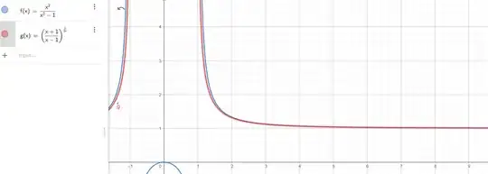

We need to prove that: $$a_{k-1}>a_{k} $$ $${a_{k-1}}^2>a_{k}^2$$ $$\left( \frac{k}{k-1} \right)^{2k-1}> \left( \frac{k+1}{k} \right)^{2k+1}$$ $$(k)^{4k} >({k+1})^{2k+1} ({k-1})^{2k-1}$$ Here I tried to use the binomial theorem to prove that $(k)^{4k} >({k+1})^{2k+1} ({k-1})^{2k-1}$, or in other form $\left(1+ \frac{1}{k^2-1} \right)^{2k} > 1+\frac{2}{k-1}$, but the sequence $\left(1+ \frac{1}{k^2-1} \right)^{2k} - 1-\frac{2}{k-1}$ converge TOO fast to $0 $ and after a lot of calculations I realised that I need to use most or all the terms in the expatiation of $\left(1+ \frac{1}{k^2-1} \right)^{2k}$ so that the RHS >LHS, so the this approach lead to a dead end. enter image description here
