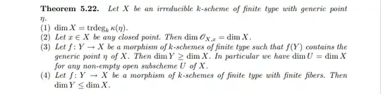

Since $X_s \to \operatorname{Spec}k(s)$ is of finite type, $X_s$ is noetherian. Let $X_s = X_1 \cup \cdots \cup X_n$ be its irreducible components, each of which is endowed with the closed subscheme structure. By the Proposition 4.4.16, we have $$\dim X_1 = \cdots = \dim X_n = \dim X_{\eta}.$$ Let $x\in X_s$ be a closed point. Then there exists $i$ such that $x \in X_i$. Note that the composition $X_i \hookrightarrow X_s \to \operatorname{Spec}k(s)$ is also finite type. Then by the Gortz's Algebraic Geometry book, Theorem 5.22. :
We have that $$\dim \mathcal{O}_{X_i, x} = \dim X_i = \dim X_{\eta}.$$
