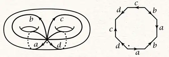

I am having a hard time constructing a genus 2 surface from 8-gon. May I request for some reference? Here's the construction I used from Hatcher: enter image description here
And here's my doodle.... I think I didn't get the identification of $b$ correctly at step (c), since I believe it $a$ shall go around the tube... enter image description here

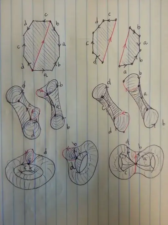

    One way is to "cheat", cutting the octagon diagonally, into two pieces, one with $c$ and $d$, the other with $a$ and $b$. Then each piece is a torus (minus a disk), and you can then glue them back together. –  Aug 29 '13 at 20:02
  • Oh, that makes sense, @SteveD. Thank you. – 1LiterTears Aug 29 '13 at 20:08

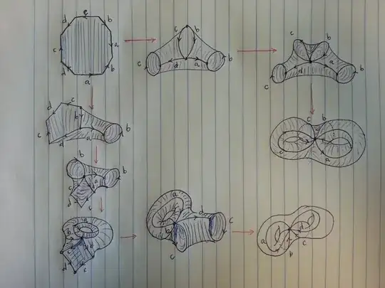

Here are two visualizations. ${}{}{}{}{}{}{}{}{}{}$
two ways of making a genus-two surface from an octogon

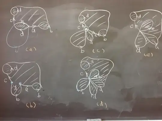

Here's a third, from Steve D's comment: third way

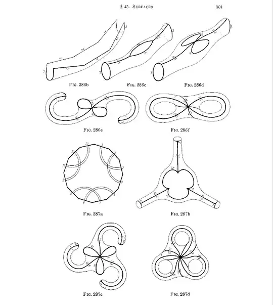

You can find this too on p. 301 of Hilbert & Cohn-Vossen "Geometry and the Imagination."
