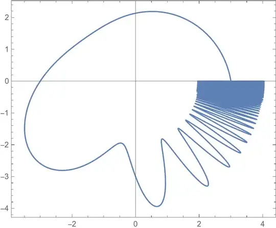

Consider $f : [0, 1) \to \mathbb{R}^2$ defined by
$$ f(t) = r(t) (\cos(2\pi t), \sin(2\pi t)), \qquad \text{where}\quad r(t) = 3 + \sin\left(\frac{\pi}{1-t}\right). $$
Below is the trajectory of $f(t)$, visually demonstrating that $U = \mathbb{R}^2 \setminus f([0,1))$ is disconnected.
Graph of f
Argument. To show that $U$ is indeed not path-connected, assume that
$$ \alpha : [0, 1] \to \mathbb{R}^2$$
is any path from $(1, 0)$ to $(5, 0)$. We want to show that $\alpha$ always passes through $f([0, 1))$. In doing so, we can assume that $\alpha$ avoids the origin. (Whenever $\alpha$ enters and exits a small circle around the origin, we can continuously deform that part by a circular arc.) This then allows to write $\alpha$ as
$$ \alpha(s) = \|\alpha(s)\| (\cos (2\pi \theta(s)), \sin (2\pi \theta(s)) )$$
for some continuous function $\theta : [0, 1] \to \mathbb{R}$. Then $g : [0, 1) \to \mathbb{R}$ defined by
$$ g(s) = \|\alpha(s)\| - r(\theta(s)) $$
has the property that $g([0, 1))$ is an interval. (In fact, $g$ has intermediate value property, meaning that the image of each subinterval of $[0, 1)$ under $g$ is again an interval.) Since
$$ g(0) \leq 1 - 2 < 0 \qquad\text{and}\qquad \liminf_{s \to 1^-} g(s) \geq 5 - 4 > 0, $$
it follows that $g([0, 1))$ contains $0$, or equivalently, $g(s^*) = 0$ for some $s^* \in [0, 1)$. Then
\begin{align*} \alpha(s^*) &= \|\alpha(s^*)\|(\cos(2\pi \theta(s^*)), \sin(2\pi\theta(s^*))) \\ &= r(\theta(s^*)) (\cos(2\pi \theta(s^*)), \sin(2\pi\theta(s^*))) \\ &= f(\theta(s^*)), \end{align*}
hence $\alpha$ passes through $f([0, 1))$ as desired.
