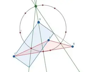

I was trying to get a feel for how to solve another question about the largest triangle that can fit in a unit square, by constructing the smallest enclosing square of a triangle in Geogebra. While doing this I 'discovered' what appears to be a new point on the nine-point circle of a triangle, that relates a rectangle to a triangle via a circle.
Here the intersection with the nine-point-circle is outside both the rectangle and the triangle.

The point is very easy to construct. Construct a rectangle such that each of the (possibly extended) sides lies on a vertex of the triangle. Since there are 4 vertices on the rectangle and only 3 on the triangle, the rectangle and triangle must always have a vertex in common. Now draw lines from each of the unshared vertices of the rectangle to the midpoint of the associated side of the triangle. These 3 lines will always intersect at a point that lies on the nine-point-circle of the triangle, although I cannot prove that formally.
This remains true even if the rectangle overlaps the triangle or is smaller that the triangle.

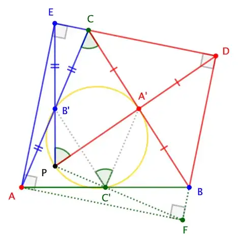

Here's a proof for a particular configuration. (Adjusting it for generality is left as an exercise to the reader.)
Let rectangle $\square AFDE$ circumscribe $\triangle ABC$, with $B$ and $C$ on $\overline{FD}$ and $\overline{DE}$, respectively. Let $A'$, $B'$, $C'$ be the midpoints of $\overline{BC}$, $\overline{CA}$, $\overline{AB}$, and let lines $\overleftrightarrow{DA'}$ and $\overleftrightarrow{EB'}$ meet at $P$.
Note that $|A'B|=|A'C|=|A'D|$ and $|B'C|=|B'A|=|B'E|$. (Why?) Then, a little angle-chasing shows that $\angle A'PB'\cong\angle C = \angle A'C'B'$. Thus, points $A'$, $B'$, $C'$, $P$ are concyclic, lying on $\bigcirc A'B'C'$, the Nine-Point Circle.
We can argue similarly about the intersection of lines $\overleftrightarrow{DA'}$ and $\overleftrightarrow{FC'}$, so that $P$ must be the point of concurrence of all three such lines. $\square$

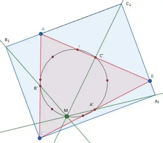

Let $CA_1C_1B_1$ be a circumscribed rectangle to triangle $ABC$ with common vertex in $C$.
Here is a simple analytical proof :
    1. showing the validity of your construction of point $M$ (the fact that straight lines $A_1A',B_1B',C_1C'$ meet in a common point).
    1. showing that $M$ belongs to the nine-points circle.
Part 1
Let us take a system of coordinates where $C$ is the center and $x$ and $y$ axes are defined by $\vec{CA_1}$ and $\vec{CB_1}$ resp. Let
$$A_1=(a,0), \ \ B_1=(0,b), \ \ C_1=(a,b).$$
$$\text{and} \ A=(\lambda a,b), \ \ B=(a,\mu b)$$
where $\lambda$ and $\mu$ can take any value (on the figure, they belong to interval $(0,1)$ but it can be any real value, covering in this way all the cases shown in the question).
With these notations, the equations of lines $A'A_1$ and $B'B_1$ are :
$$\begin{cases}b x+\lambda a y &=&\lambda a b\\ \mu b x+a y &=&\mu a b\end{cases}$$
Let us define $M$ as the intersection of these lines. Solving the system above, we get the coordinates of point $M$ :
$$M=\left(x_M=a \frac{\lambda(\mu-1)}{\lambda \mu -1}, y_M=b \frac{\mu(\lambda-1)}{\lambda \mu -1}\right)$$
Having these coordinates, it is not difficult to show that $M,C',C_1$ are aligned, ending part 1 of the proof.
Part 2 : In this system of coordinates, the equation of the 9-point circle is of the form :
$$-2ux-2vy+w+(x^2+y^2)=0,$$
Let $X(x,y)$ be the generic point of 9-point circle. Let us express that $A',B',C',X$ are concyclic, i.e., that their coordinates verify
$$\begin{cases} -2ux_{A'}-2vy_{A'}+w+(x_{A'}^2+y_{A'}^2)&=&0\\ -2ux_{B'}-2vy_{B'}+w+(x_{B'}^2+y_{B'}^2)&=&0\\ -2ux_{C'}-2vy_{C'}+w+(x_{C'}^2+y_{C'}^2)&=&0\\ -2ux-2vy+w+(x^2+y^2)&=&0\\ \end{cases}$$
These four constraints can be expressed under the following form :
$$\underbrace{\begin{pmatrix}a&\mu b&1&(a^2+\mu^2b^2)\\ \lambda a&b&1&(\lambda^2 a^2+b^2)\\ (\lambda+1)a&(\mu+1)b&1&((\lambda +1)^2 a^2+(\mu+1)^2 b^2)\\ 2x&2y&1&4(x^2+y^2) \end{pmatrix}}_P \underbrace{\begin{pmatrix}-u\\-v\\w\\1/4\end{pmatrix}}_V=\begin{pmatrix}0\\0\\0\\0\end{pmatrix}\tag{1}$$
Homogeneous system (1) has a non trivial solution $V$ if and only if the determinant of matrix $P$ (as defined above) is zero, giving an expression involving indeed a second degree polynomial in $x,y$.
Now, it remains to check that replacing $(x,y$) by $(x_M,y_M)$ still gives a zero determinant. This can be done by using a CAS (Computer Algebra System). It is what I have done with a little SAGE script (I can give details).
This $4 \times 4$ determinant equal to $0$ can be brought to this $3 \times 3$ form (by subtracting rows 1 and 2 to row 3, then adding the new row 3 to all other rows, then make a Laplace expansion) :
$$\det \pmatrix{a&\mu b&(a^2+\mu ^2b^2+\nu)\\ \lambda a&b&(\lambda^2a^2+b^2+\nu)\\ 2x&2y&(x^2+y^2+\nu)}=0 \ \ \text{with} \ \ \nu:=2(\lambda a^2+\mu b^2)$$
This equation can be further simplified under the following form :
$$x^2+y^2+\nu-\frac{2}{ab(1-\lambda \mu)}\left(bx \ \ ay\right) \pmatrix{1 & (-\mu)\\(- \lambda ) & 1}\pmatrix{a^2+\mu^2b^2+\nu\\b^2+\lambda^2a^2+\nu}=0$$
Now, the final question : can $M$ be considered as a point-center ? I would say no because of its dependence upon the chosen enclosing rectangle.
