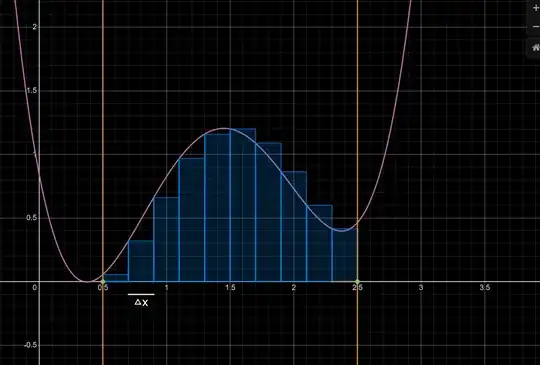

Now I would also want to talk about Area. To get the Area of the curve we divide it into little rectangles with the width of $\triangle x$ which tends to 0 bur $\triangle x \ne 0$
Mathematically area will be:
$$ A() = \lim_{\triangle x \to 0} \triangle x \sum_{i=\alpha}^\beta f(x_i + (i-1)\triangle x) $$
Since from pic $\alpha = 0.5\ \ \beta = 2.5$ the above equation is:
$$ A() = \lim_{\triangle x \to 0} \triangle x \sum_{i=0.5}^{2.5} f(x_i + (i-1)\triangle x) $$
This equation by definition of integration is:
$$ \int_{\alpha}^\beta f(x) \triangle x $$
Now Fundamental Theorem of Calculus says
$$ \int_{\alpha}^\beta f(x) \triangle x = F(\beta) - F(\alpha),\ \ F'(x) = f(x) $$
Q2 - 3:
Q2. What is the relation of Area to antiderivative function?
Q3. How one thus comes to the logic of Subtracting from a geometrical perspective, here above image.

    "Now I asume at $\infty$ it is $f(b) - (a)$" What makes you think so? – Anne Bauval Oct 12 '23 at 13:28
    If $a$ is on the left side if its rectangle, then $b$ should also be on the left side of its rectangle. Then the horizontal separation is indeed $dx$. Also, the notation is terrible. You should be using $\Delta x$ instead of $dx$ because $dx$ is an infinitesimal, not a positive length. – MPW Oct 12 '23 at 13:30
  • @anne I don’t know what to do from there. I just thought it would reach it but evaluation of limit will give another answer. –  Oct 12 '23 at 13:32
  • @mpw in those rectangle I meant to make their width indefinitely small so that I could ignore dx. But that didn’t work out for me. –  Oct 12 '23 at 13:34
    In the diagram $b = a + 2, dx$, so as $dx \to 0$, "optimistically" I'd expect$f(b)-f(a) \to 0$ while$$\frac{f(b)-f(a)}{2,dx} = \frac{f(a+2, dx) - f(a)}{2, dx} \to f'(a).$$ – Andrew D. Hwang Oct 12 '23 at 14:35
  • @AndrewD.Hwang how did you deduce $f(b) = f(a) + 2\ \mathrm{d}x$ Isn't the change in x axis ie. width of rectangle $\mathrm{d}x$ not little change in function itself $\mathrm{d}f(x)$ that you are referring to? –  Oct 12 '23 at 16:02
    Careful: Not $f(b) = f(a) + 2,dx$, but $f(b) = f(a + 2,dx)$. The "$2,dx$" is inside $f$; we have $b = a + 2,dx$, and can substitute in $f(b)$. :) – Andrew D. Hwang Oct 12 '23 at 17:11
  • @EthanBolker I've changed the question, I would appreciate it if you review it. –  Oct 12 '23 at 18:01
  • @AnneBauval I've changed the question, I would appreciate it if you review it. –  Oct 12 '23 at 18:01
  • @MPW I've changed the question, I would appreciate it if you review it. –  Oct 12 '23 at 18:01
  • @AndrewD.Hwang I've changed the question, I would appreciate it if you review it. –  Oct 12 '23 at 18:02
