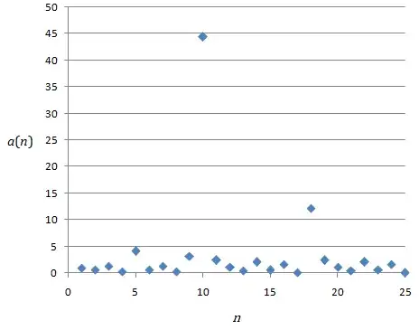

Here is the graph of $a_n$ against $n$, for $1\le n \le 25$.

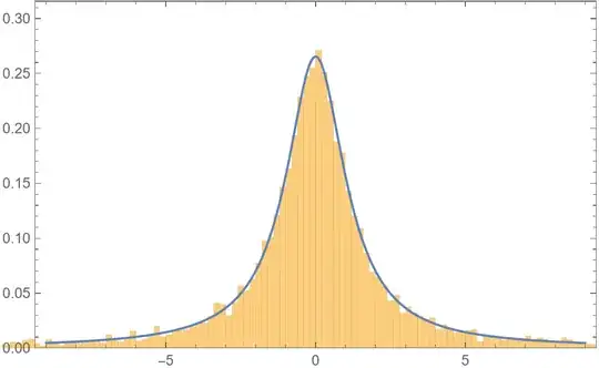

Addendum. Below is the probability histogram of first $10^4$ terms of $(x_n)$ and the graph of PDF of the limiting Cauchy distribution $\mu$:
Comparison

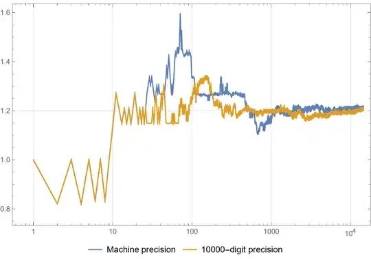

Caution. Numerical simulation are not totally suited for probing the behavior of the median.
This is because the sequence $(x_n)$, hence $(a_n)$, is very susceptible to small numerical errors, which is significantly amplified when a term gets close to one of the poles of $\cot$. (This is essentially due to loss of significance.)
For instance, simulating $n \mapsto \text{median}(a_1,\ldots,a_n)$ using machine precision and $10000$-digit precision shows fairly different behavior even starting around $n = 20$:
Comparison

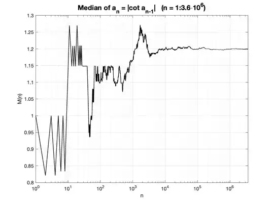

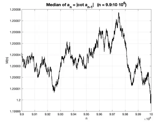

I've expanded my examination of this problem. I have run out the sequence to $n=10^7$ with $a_1=1$, as before. I attempted to find the median for each value of $n$ but it was too time consuming. I stopped the calculation at $n\approx 3.5\cdot10^6$ and then continued the calculation for the last 100,000 points. The results are shown in the two figures below. As you can see in the second figure, the results do not settle down to a constant value at all. It is my opinion that they never will.
Median 1:3.6M
Median detail
