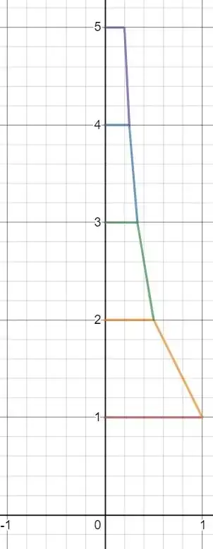

Pick any sequence $X=\{x_n\}$ from $[0,1]$. For the sequence of functions $F=\{f_n\}$ to be pointwise bounded on $X$ would mean the sequence $$f_1(x_n)\:\:\:f_2(x_n)\:\:\: f_3(x_n) \:\:. . .$$ to be bounded for every $n$. For each of the functions to be bounded on $X$ would mean the sequence $$f_n(x_1)\:\:\: f_n(x_2)\:\:\: f_n(x_3)\:\:. . .$$ to be bounded for every $n$. Keeping this in mind I construct the following double sequence : \begin{matrix} 1&1&1&1&\dots\\ 1&2&2&2&\dots\\ 1&2&3&3&\dots\\ 1&2&3&4&\dots\\ \vdots&\vdots&\vdots&\vdots&\vdots \end{matrix}
Since each row and each column is bounded (eventually constant) we have a pointwise bounded sequence of bounded functions. But since the diagonal is $(1,2,3,4,...)$ the sequence is not uniformly bounded.
Continuity can be achieved very easily as well. For instance :
on (0,1]

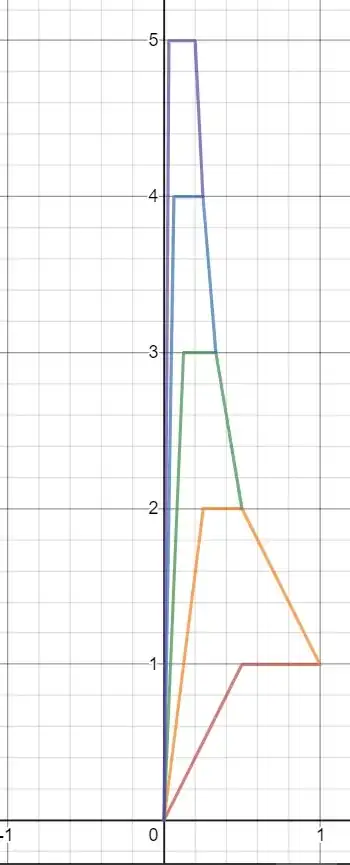

Of course this only works on $(0,1]$ since the sequence is not pointwise bounded on $0$. To include $0$ some modification is required :
Here the $nth$ function reaches the top at $\frac{1}{n}$ and starts declining at $\frac{1}{2^n}$. The flat top of the functions will forever keep pushing to the left, never reaching zero; exhibiting the pointwise boundedness of the sequence.
Notice how the pointwise limit on $(0,1]$ is the same in both the cases.
