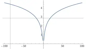

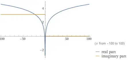

I think that one of the reasons is that, for most cases, $\ln |x|$ "works" better. First of all, you don't have to deal with complex numbers. Second, it "automatically" works for finding areas under the curve.
The problem with $\ln(x)$ is that (a) you have to deal with complex numbers, and (b) you have to deal with the discontinuity at $x=0$.
Technically, at a discontinuity, you can have different values for $C$. Anyway, this all requires a lot more explanation and doesn't gain much value when working with real numbers. Note that the only difference for between the complex $\ln(x)$ and the $\ln(x)$ for real inputs is an additive (complex) constant on the negative side. You can think of $\ln |x|$ as being identical to $\ln(x)$ but automatically adding $-i\pi$ to the constant on the negative side of the graph.
See the graph of $\ln |x|$:
Graph of ln |x|
See the graph of $\ln(x)$:
Graph of ln(x
Personally, I like the idea of just using $\ln(x)$, but just realize that it introduces a lot of issues and questions students may not be prepared to deal with.
