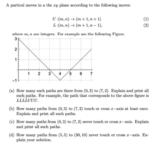

I'm currently working on a problem involving path counting in the $x-y$ plane, and I could use some guidance on how to approach it. The problem is as follows:
My approach to solving (a) was that we start at the point $(0,3)$ and need to reach the point $(7,2). In each step, we can either move up one unit and to the right one unit (denoted as U), or move up one unit and to the left one unit (denoted as L). To reach our destination, we must take 3 "U" steps and 4 "L" steps. This is because we need to go from a starting y-coordinate of 3 to a final y-coordinate of 2 (a difference of 1), and move 7 units in the x-direction. Now, the question is how many different combinations of 3 "U" steps and 4 "L" steps we can take, where the order of the steps doesn't matter. To count these combinations, we can use combinatorics. One way to do this is by calculating the binomial coefficient "7 choose 3," which is also denoted as "C(7,3)." This can be computed as: C(7,3) = 7! / (3!(7-3)!) = 35.
But I am not sure if this correct?
As for (b) to (d), I am not really sure how to solve the questions and would like some help.

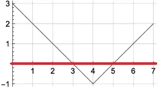

For (B) and the rest, imagine a red line at $y=0$

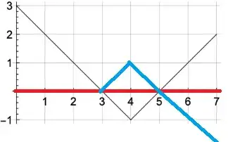

A path which starts at $(0,3)$ and ends at $(7,2)$ who touched or crossed this red line corresponds uniquely to a path which starts at $(0,3)$ and ends at $(7,-2)$ and can be found by reflecting the path across the red line from that point where it first touched the red line. The pictured path having touched at $(3,0)$ will correspond to the new path in blue.
Indeed, one can prove that every path from $(0,3)$ to $(7,-2)$ corresponds to such a "reflected" path, which then corresponds uniquely to paths from $(0,3)$ to $(7,2)$ which touched or crossed the $x$-axis.
The answer to (B) is then the same as the number of paths from $(0,3)$ to $(7,-2)$
This is formed by one $U$ moves and six $D$ moves (or L moves if you prefer) in any order, for a total of $\binom{7}{1}=7$ such paths
