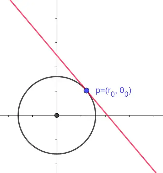

I'm trying to visualize what $\hat{\mathbf e} _{\theta}$ means. At some point $p=(r_0, \theta_0)$, we can look at two "curves" - the first is a stright-line (denoted in red), the other is the "circle", denoted in black. What displacement does $\hat{\mathbf e} _{\theta}$ represent - along the red curve or the black curve?
