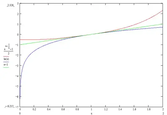

Consider the following graphs.
They suggest to split the required inequality into the inequalities $\ln x\le x-1$ and $x-1\le \frac{x^{x+1/x}-1}2$. Then first of them follows from the inequality $1+t\le e^t$, which holds for each real $t$. The second transforms into the inequality $2x-1\le x^{x+1/x}$. The latter holds when $0<x\le \tfrac{1}{2}$, because then the left-hand side nonpositive, whereas the right-hand side is nonnegative. The inequality also holds when $x\ge 1$, because then $x^{x+1/x}\ge x^2\ge 2x-1$.

    Moreover, $y=2x-1$ is the common tangent line at $x=1$ to both $y=2\ln x-1$ and $y=x^{x+1/x}$. It is easy to show that $2\ln x-1$ is concave down on $(0,\infty)$, so the difficult part is to show (by hand) that $y=x^{x+1/x}$ is concave up on $(0,\infty)$. Mathematica shows that right away, since no roots of the second derivative of $x^{x+1/x}$ are real, and thus the convexity does not change. A bit of calculus also shows that the second derivative of $x^{x+1/x}$ at $x=1$ is $1>0$, so $x^{x+1/x}$ is concave up on $(0,\infty)$. – Alexander Burstein Aug 25 '23 at 01:20
