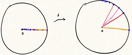

  5. Let us now assume $f$ is not (right-)continuous at $0$, and normalize $f(0)=0$. I think user TheEmptyFunction's answer to the above linked MO post https://mathoverflow.net/a/353018/112504 also applies here to tell us that there are arbitrarily small radii $\epsilon>0$ s.t. there is a sequence $y_n^\epsilon \searrow 0$ s.t. $f(y_n^\epsilon) \in C(0,\epsilon)$ ---- (illustrated below as the blue points, which I think we can normalize via pre-composing with a homeomorphism of $[0,1]$ and post-composing with a homeomorphism of $\mathbb R^2$ to be $\{\frac 1m: m \in \mathbb N^+\}$ in the domain, and $i\cdot e^{-\pi/2 \cdot \frac 1m})$ in the codomain, with $\epsilon=1$)
    initial segments mapped to path connected
    By mapping $(\frac 1{m+1},\frac 1m]$ to the line segment between $0\in \mathbb C$ (not inclusive) and $i\cdot e^{-\pi/2 \cdot \frac 1m} \in \mathbb C$ (inclusive) in a linear manner say (illustrated above), we get an injective map $[0,1]\to \mathbb R^2$ that maps any interval $[0,a\rangle$ (where the right-hand bracket $\rangle$ denotes both "$)$" and "$]$") to a path-connected set in $\mathbb R^2$ (perhaps we could say this function is a "initial-segment path-connected map"); but any interval $(0,a\rangle$ would not map to a path-connected set.

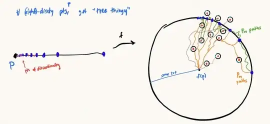

In any case, assuming $f:[0,1] \hookrightarrow \mathbb R^2$ has a discontinuity at $p\in [0,1]$ (e.g. $p=0$ as I normalized above), the paths $F_m$ and $P_m$ that are guaranteed (by path-connectedness of the map $f$) make us have a picture that looks like what follows, with the green $F_m$ paths and orange $P_m$ paths. If indeed we have infinitely many points of discontinuity (illustrated in red) converging to $p$ from the right, then each of those points will lead to another version of this tree structure in the codomain (which I have suggested in the small circles around the red points in the codomain).
diagram for proof of infinite discontinuities
All images of intervals $[p, p+\eta\rangle$ (where "$\rangle$" refers to both "$)$" and "$]$") will map to such a tree. Subtracting 2 such intervals leads to general intervals $\langle p+\delta, p+\eta\rangle$ which get mapped to a tree like above, with some portion (portions on the left in the above picture) cut off. But if the tree is super "well-connected" with threads weaving throughout the "canopy", I can imagine that the set remains path-connected.
So perhaps the Conjecture above is false, if one can construct an injective map from $[0,1]$ to this fractal tree-like structure.
