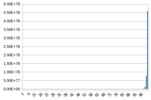

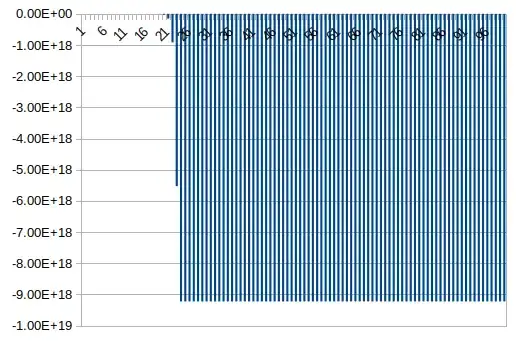

  • I tried a sample with GNU Octave too to get an idea:
a=2/3;
b=9;
x=linspace (0,2/b,1000);
data = [];
for n =1:100
   y=(a*b)^(n+1) *sin(b^(n+1)*pi*x) - (a*b)^(n)*sin(b^(n)*pi*x);
   data = [data; n min(y) max(y)];
endfor
Below charts show min(y) and max(y) for different values of n:
Although above charts show that growth speed is very rapid (like exponential functions); but again I could not find a way to prove it.
