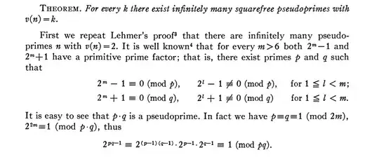

I believe this is what you're looking for: This is from a 2-page paper by Erdos titled "On the Converse of Fermat's Theorem": https://www.math.stonybrook.edu/~moira/mat331-spr10/papers/1949%20ErdosOn%20the%20Converse%20of%20Fermat's.pdf
Additionally, as pointed out by Peter in the comments, your question is equivalent to asking if there are infinitely many Poulet numbers with 2 factors (also super-Poulet since all divisors are prime) where a Poulet number is a number that is a pseudoprime to base 2. So by this definition, Erdos actually extends a proof by Lehmer to show there are infinitely many Poulet numbers with any number of factors. Not only that, his argument shows that, for any prime $p > 13 ~ $ there exists $ q $ for which $pq$ is a Poulet number.
