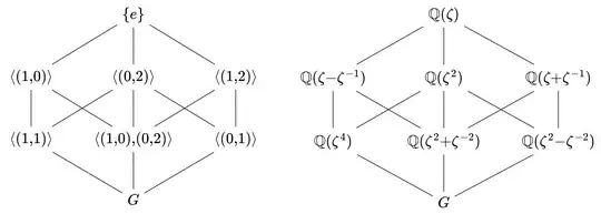

Now I want to draw the lattice of subfields of this extension, which corresponds to the subgroup lattice of $C_2\times C_4$. Here is my result. enter image description here

  1. Are these lattices correct?
  2. I basically used brute force to search for elements that are fixed under the various subgroups and calculate their minimal polynomials, and then use the degrees of extensions to deduce that they're the correct subfield. But this method is laborious. Is there an easier algorithm?

  • Related. A point being that you might have avoided the mistakes pointed out by KCd by writing down the generators in simpler forms. The quadratic extensions are $\Bbb{Q}(i)$, $\Bbb{Q}(\sqrt2)$ and $\Bbb{Q}(\sqrt{-2})$. All subfields of $\Bbb{Q}(\zeta_8)$ actually. There is the real subfield $\Bbb{Q}(\cos(\pi/8))=\Bbb{Q}(\sqrt{2+\sqrt2})$. Well done identifying the last field as $\Bbb{Q}(\zeta-\zeta^{-1})$. – Jyrki Lahtonen Aug 14 '23 at 05:56
  • Anyway, four out of the six intermediate fields are subfields of $\Bbb{Q}(\zeta_8)$, so first working out the eighth cyclotomic field seems to be a logical starting point. – Jyrki Lahtonen Aug 14 '23 at 05:58
  • Above $\zeta-\zeta^{-1}=i\sqrt{2-\sqrt2}=2i\sin(\pi/8)$. Why would that field contain $\zeta^4=i$? – Jyrki Lahtonen Aug 14 '23 at 06:03
  • I can't shake the feeling that you had seen the lattice of subgroups of the elementary 2-abelian group of order 8, and wanted to match that willy-nilly :-) – Jyrki Lahtonen Aug 14 '23 at 06:20
  • @JyrkiLahtonen I drew two extra vertical lines in the lattice. One is on the left and the other is on the right. Would everything else be correct if those are removed? – Sardines Aug 14 '23 at 15:26
  • I think so. FWIW the upvote is from me. You had the sense to describe in detail what you think about the problem. That makes it a lot easier to help. – Jyrki Lahtonen Aug 15 '23 at 15:22

Your upside-down subgroup diagram for $C_2 \times C_4$ has mistakes. As an example, the cyclic subgroup $\langle (0,1)\rangle$ with order $4$ has just one subgroup of order $2$, but you wrote two subgroups of $\langle(0,1)\rangle$ with order $2$. As another example, $\langle (1,1)\rangle$ is cyclic of order $4$, so it too has just one subgroup of order $2$, but you gave $\langle (1,1)\rangle$ two subgroups of order $2$.

  • Yes, there are two extra vertical lines in the lattices that shouldn't be there. Would everything else be correct if those are removed? Also, why are $\zeta\mapsto\zeta^{-1}$ and $\zeta\mapsto\zeta^5$ much nicer generators of $(\mathbb Z/16)^\times)$? They all look similar to me. – Sardines Aug 14 '23 at 15:25
