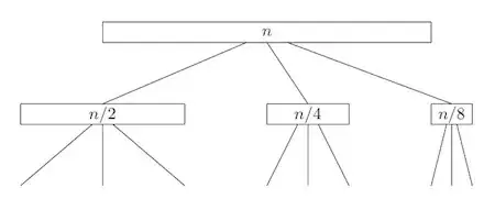

This problem is given in "Introduction to Algorithms", by Thomas H. Cormen.
I have the answer to it, but I don't understand it.
The answer is, $T(n) = \Theta(n)$.
It would be really good if you can explain it using recursion tree.
Here are the top two layers of the recursion tree:
All subsequent levels will have the same pattern: dividing the node of size $k$ into three pieces, of size $k/2, k/4,\text{ and }k/8$. The contribution of the lecond-level nodes will be $(7/8)n$, and you can convince yourself that the contribution of the third level (which I haven't drawn) will be $7/8$ of the total contribution in the second level, namely $(7/8)^2n$. If this were to be continued forever the total contributions to $T(n)$ would be $$ n+\left(\frac{7}{8}\right)n+\left(\frac{7}{8}\right)^2n+\left(\frac{7}{8}\right)^3n+\cdots $$ so we have a geometric series and thus $$ T(n)\le \frac{1}{1-\frac{7}{8}} = 8n $$ for our upper bound. In a similar way, we could count just the contribution of the leftmost branches and conclude that $T(n)\ge 2n$. Putting these together gives us the desired bound, $T(n)=\Theta(n)$.
