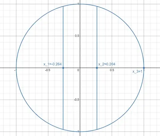

If I want to cut a circle into $n$ equal parts,
For example: enter image description here
In this case ($n=3$), $x_1≈-0.264$ and $x_2≈0.264$, where $x_1$ and $x_2$ are values that sactisfy $\int_{-1}^{x_1}\sqrt{1-x^2}\mathrm{d}x=\int_{x_1}^{x_2}\sqrt{1-x^2}\mathrm{d}x=\int_{x_2}^{1}\sqrt{1-x^2}\mathrm{d}x$
And my problem is to find a generalised formula for $x_1,x_2,x_3...x_{n-1}$ when I cut the circle into $n$ equal parts.
The furthest I have gone is that $x_1$ is a value that sactisfy $\arcsin{(x_1)}+x_1\sqrt{1-x_1^2}=\frac{\pi}{n}-\frac{\pi}{2}$ which I couldn't solve for $x_1$

    Do you have a reason to think a formula for the answer exists? – aschepler Aug 08 '23 at 00:22
  • If you have a formula for $x_1,$ then you have determined the area $\pi/n$ and the angle $\alpha$ at the center of the segment. This is a function of the angle $\alpha$ and sine of the angle $\sin(\alpha)$. I do not see how you can solve this in a closed algebraic expression. It is probably out of reach for compass and straightedge, and likely also for more general algebraic expressions. – Marius S.L. Aug 08 '23 at 00:45
    There is a calculator for doing this at https://planetcalc.com/8943/ and they also give the equations (but they note that the equations can't be solved algebraically, only numerically). E.g., for a circle of radius $100$ cut into seven equal pieces, the widths of the pieces, to two decimal places, are $40.09,25.56,23.10,22.49,23.10,25.56,40.09$. – Gerry Myerson Aug 08 '23 at 02:25
  • Your equation is a Kepler equation as if $x=\sin(w)$, then the equation to solve is $w+\sin(w)\cos(w)=\frac\pi n+\frac \pi 2$. There is a Mathematica closed form and linked integral/series representations in this answer – Тyma Gaidash Aug 13 '23 at 01:19
  • Are you talking about the circle (so equal arclengths) or the disk (so equal areas)? It is not clear without reading on. This is a typical confusion with the ambiguity of the word circle. – Ted Shifrin Aug 13 '23 at 01:33
For $n$ equal parts, the values of positive $x_k$'s are the solutions of the equation you wrote
$$\arcsin{(x_k)}+x_k\sqrt{1-x_k^2}=\frac{\pi}{2}-k\frac{\pi}{n}$$

For example, for $n=7$, the results would be
$$\left( \begin{array}{ccc} \text{approximation} & \text{solution} \\ \pm 0.112437 & \pm 0.112437 \\ \pm 0.343474 & \pm 0.343478 \\ \pm 0.598821 & \pm 0.599061 \\ \end{array} \right)$$
