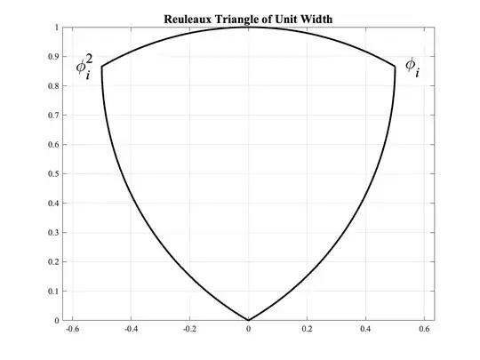

If we look at the normalized Reuleaux triangle (i.e., of unit width) as in the figure below, we’ll see that the corners are given by $\varphi_i,\ \varphi_i^2,\ \varphi_i^2-\varphi_i+1=0$. It’s also worth noting that the centroid is given by the average of these three points, to wit, $z_c=i/\sqrt{3}$.

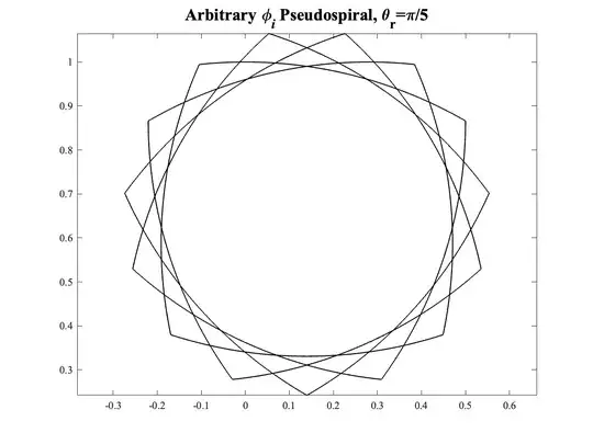

It was no trouble to set up a sequence of the imaginary golden ratio, say $S=\varphi_i^n$ to test it as a pseudospiral. However, the expectation is that the spiral will not grow, per se since the absolute value of $\varphi_i^n$ is unity. The first figure below shows such a spiral with $\theta_r=\pi/5$. Now, we know that $\varphi_i^n$ repeats in series of three, that is, $\varphi_i^4=\varphi_i^1$ and so on, So, if we set $\theta_r=\pi/3$ we’ll only need three terms to complete our 'spiral,' as shown in the second figure below. And that is the Reuleaux triangle, which can be expressed analytically as
$$z=\varphi_i e^{i\theta}-( e^{i\theta}- e^{i\pi/3})u(\theta-\pi/3)- \varphi_i ( e^{i\theta}- e^{i2\pi/3})u(\theta-2\pi/3);\quad \theta\in[0,\pi]$$

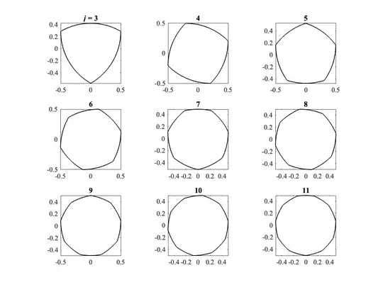

From here it’s an easy stretch to see that the remaining Reuleaux polygons (and the even ones, as well) can be had by setting $\varphi_j=e^{i\pi/j}$, $\theta_r=\pi/j$, and $\theta\in[0,\pi]$. A sampling of results for $j=(3:11)$ is shown in the third figure below.
