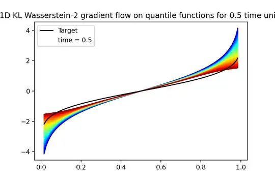

The following is a plot the evolution for the above mentioned initial condition, but the simulation breaks down for $t > \frac{1}{2}$. 1D KL W2 GF

  • Wolfram gives a solution to the steady-state equation in terms of $\mathrm{erf}^{-1}(ax+b)$ as well. The functional $F[\gamma_t] = \int_0^1 \gamma_{t}(x)^2(x) \ dx$ follows the equation $F' = -F + 1 - \left[\frac{\gamma_t}{\gamma't}\right]{0}^1$. I believe for both your ansatz the boundary term tends to a constant so the equation tends to constant $L^2$ norm like $e^{-t}$. This seems to indicate that this $\mathrm{erf}^{-1}$ function might be a stable fixed point for some class of initial conditions with nice boundary behavior. – whpowell96 Jul 24 '23 at 23:54
