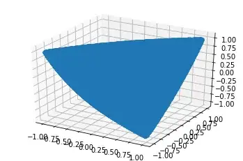

Here is what the result looks like: enter image description here
This looks like a 2-dimensional region (specifically the region inside a triangle). But I would have expected a 3-dimensional region because there are 3 variables, and the condition that all 3 eigenvalues be positive sounds like it should yield a (complicated) system of inequalities.
Curious, I then modified the code to instead generate 1 million matrices and count how many were positive definite. The answer was 616,734. So the plot was misleading and in fact more than half the matrices are positive definite.
So why is the plot misleading? What should it actually look like? What can we say about higher dimensional cases? (I know from counting 7x7 matrices that positive definite matrices are much rarer than 1/2^7, but can we say more?)

In three dimensions, your matrix is $$ \pmatrix{1&a&b\cr a&1&c\cr b&c&1\cr} $$ with determinant $$ 1+2abc-a^2-b^2-c^2 $$ which is negative (thus making the matrix not positive definite) whenever two of the numbers $a,b,c$ are big enough that their squares add up to more than $1$, and the third number is small enough that $2abc$ doesn't compensate.
E.g., one can work out that if $a=b=0.8$ then the determinant is negative for $c<0.28$.
